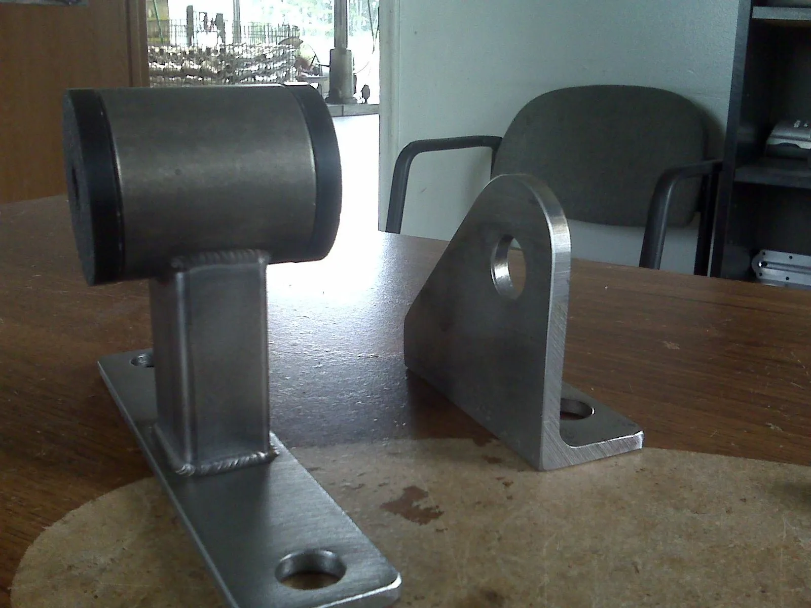

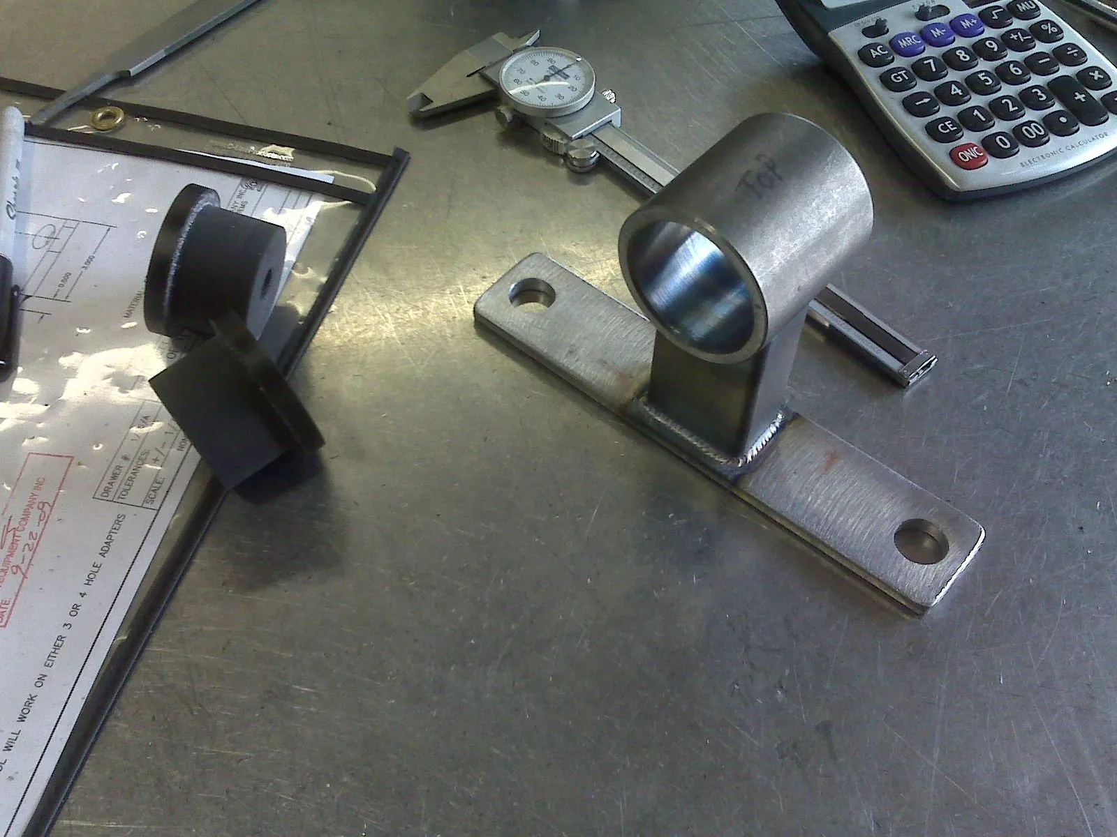

Well I decided that I'm just going to machine my own.
It will look kinda like the sls one but way different at the same time.
Just got done with all my measurements!!!
Also just picked up my urathane, and is suppose to be an 85-90durometer. (Man I hate working with that crap!)
I just can't bring myself to spend that kind of money on something that looks like that, to me their is not much there for the money, just my 2cents. And I have scrap laying around I can use!!
I will post pics when I get some of the work done! WISH me luck.

Well made some progress today!!!(alright)
Got both parts made and all tig'ed up. Made the bushings. Gona try and get the bolt tonight after work, and might try for a test fit also tonight. Then paint!!
Will post more pics later.
(sorry for the crapy b.b. cell phone photos.)
