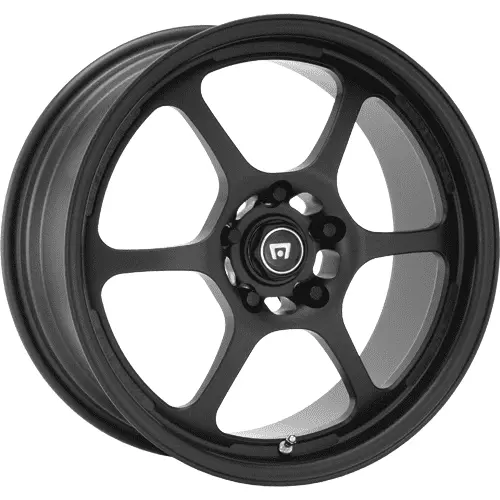

I've got a question regarding the following 2 wheels...
Traklite
Traklite2
I like the look/idea/features of the Traklite2 wheel, but for some reason the Motegi website doesn't seem to think they'll fit on an MS3... The website does say the original Traklite wheels will work though.
The only difference I can see between the 17x8 Traklite (1) wheels and the 17x8 Traklite2 wheels is the "Backside" measurement. The backside on the 1s is 6-1/4 and on the 2s it's 6-1/8.
What's this "backside" thing?
Anyone have any personal experience with these wheels?

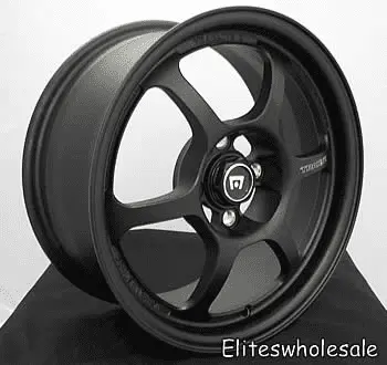

Welp, I picked them up! Some all-black teflon coated mamma-jammas! They might look a little funny on a silver MS3, but I don't care... they'll be easy to clean!
As is written on the picture, I got em from Eliteswholesale out of Cincinnati, Ohio... Included with the price was 4 centering ring things and some black spline lug nuts... not bad!

Welp... Some wheels came last Thursday... The shipping was fast, but they weren't the correct rims. I got the original Traklites in black which I don't exactly want... I'm debating taking a small refund or returning them. Leaning toward returning.
Traklite
Traklite2
That backside stuff is crap, but OFFSET is far more important. With an 8" wheel, we need a lot of room, say 48mm or better. 50+ would be better still. Problem is, lots of wheels simply aren't made this way.
Put this way, if Tirerack says they'll fit (and they carry Motegi), then they will fit, but if you are just guessing wheels then I'd probably bet on them being too shallow on offset (like 40mm), and they WILL RUB!
