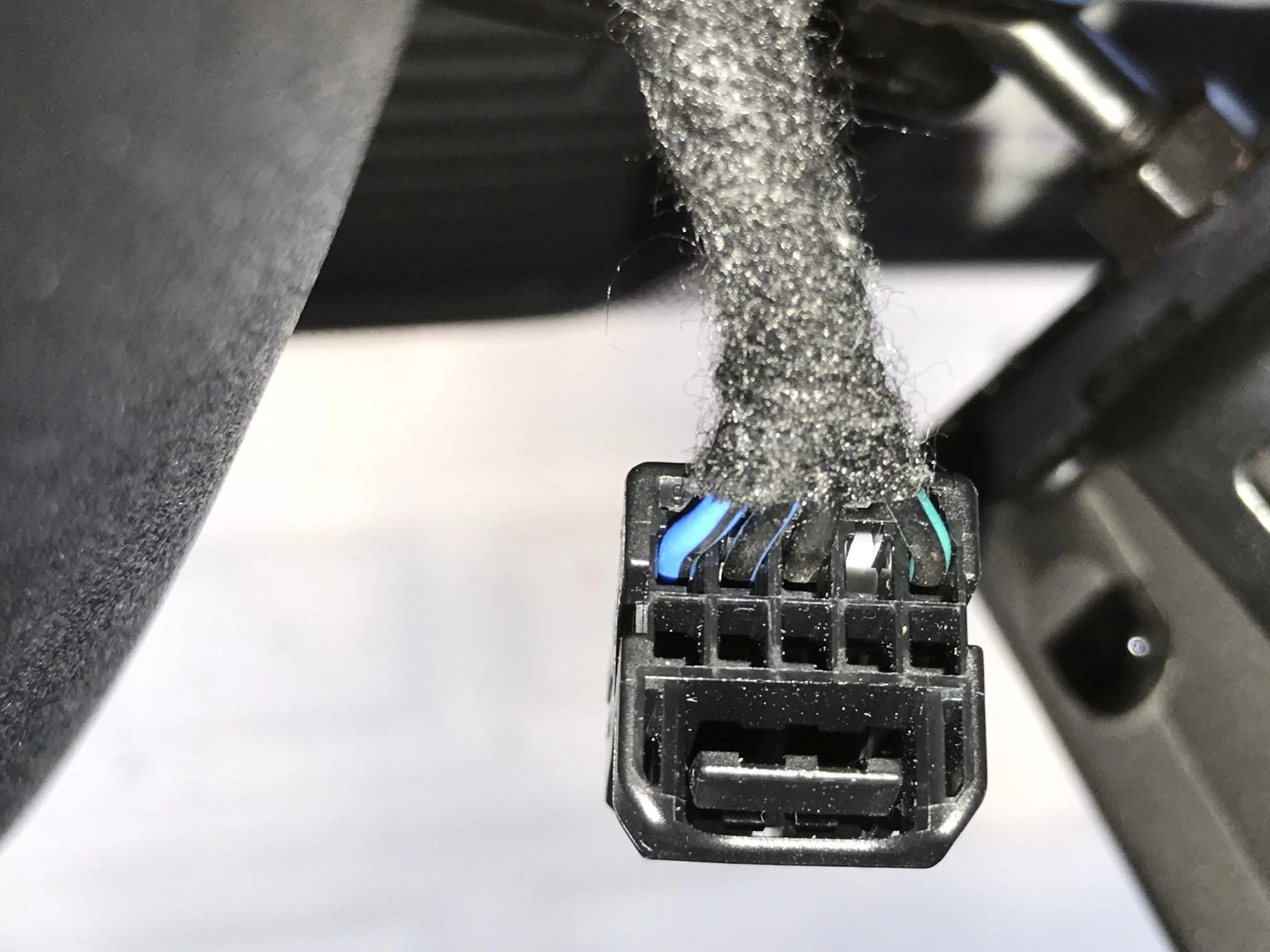

Left to right. I put the black tap on wire 3(3rd position) and the red tap on wire 4 (5th position).
Edit: NO that one was always on.
Which wires did you connect to? Does your harness look like mine? 2018 GT 4 wires in harness and 5 possible positions.
Left to right in pic
1-Blue with black stripe, 2-Black with blue stripe, 3-Black, 4-open space, 5-Black with white stripe.
with black tap in position 3 and red tap in position 5, the radar detector is alway on.

With the rear view harness plugged in and looking at the back of the mirror from L to R,
- The middle (3rd) hole with the black wire is where the black MirrorTap lead is.
- To the immediate right of that, (4th hole) is where the red MirrorTap lead is plugged in.

Fruitwolf- so you tapped into the empty socket? That is if we are looking from the same orientation. I didn't even think to try that one. It would have been much easier to fit.

Hey Bluechip, I'm wondering if the Signature and the GT have different wiring harnesses.
In mine, both ground and hot sockets (hole 3 and 4 from l to r) already have a wire in them, none are empty.
Same harness but maybe the Sig has more overhead led accent lighting. That is the only thing that would make sense from the options list. The GT has two pushbutton lights and the always on tiny led. Does the Sig have more than that?
Can you see the attatchment pic in post #4?
Ok, now I see. The pic you posted shows the harness upside down relative to how it snaps into the mirror.
Ours are the same!
I just did the mirror tap for my dash cam on the 2018 CX-9 GT. Have the 4 wires as well.
The black wire in the 3rd position is ground. The blue wire with the black stripe in the first position is powered when the car is on only. Those are the two wires I tapped.
As for the light being on, that's not the home link light, that's just the indicator light for whether your autodimming is on or off.
