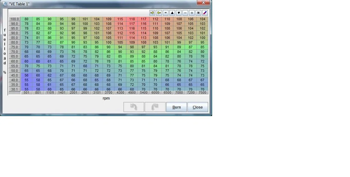

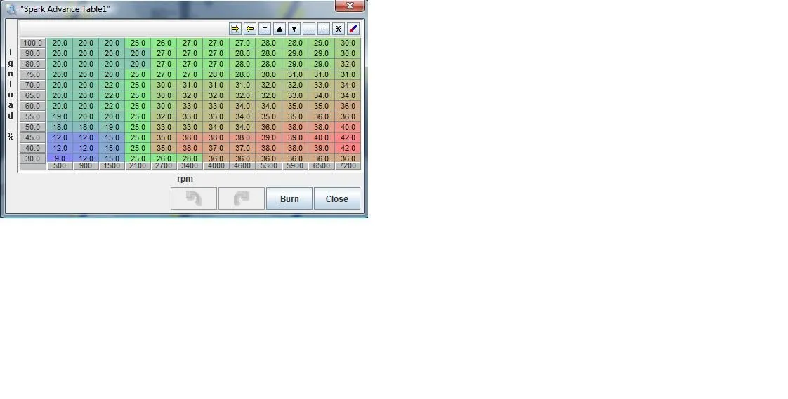

Maps
Well i got base maps form the powersquirt website that someone had posted on the forum not too long ago, and I fine tuned from there... I am not running it real hard or doing too much tuning right now because im planning to turbo soon, so ill really tune it only then, but these are running really well for right now
timing
Yes, I do need to check the timing.... But since we have the ford 36-1 wheel, the missing tooth should be bang on 80 BTDC.
please for god sakes DO NOT use powersquirrts map... its completely ******* junk.
use this instead...
http://www.mazdas247.com/forum/showthread.php?t=123775104&highlight=megasquirt
Like I said, I used them only as a base, I tuned it after that, I needed something to get it up and running you know... Thanks for these maps though, I'm sure ill be checking it out. Again, I am not too worried about this tune right now because ill be going turbo very soon and I don't wanna have to tune all over again.
Ive just posted an official guide, but remember the powersquirt timing map is wayyyyy off, its TOO overly advanced in low rpm range.
Thanks, will keep that in mind... I saw the guide, Looking forward to see it completed.
^^****** really?
