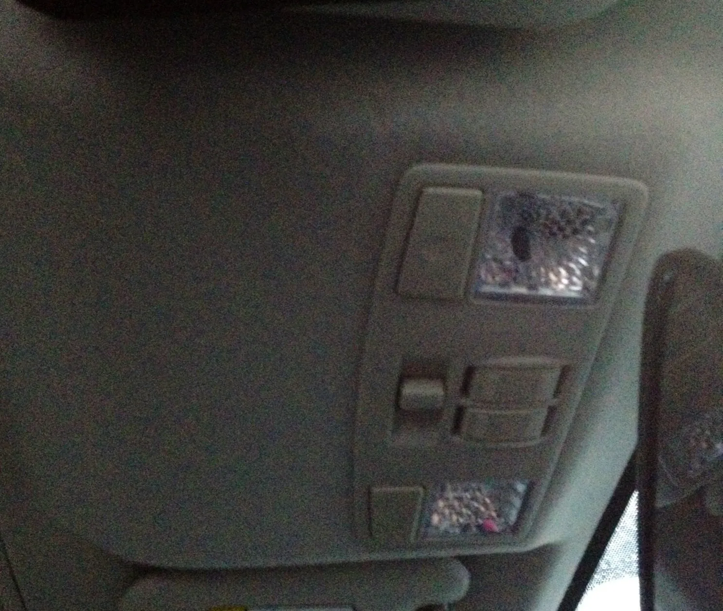

Doesn't work. I just figured I'd post up here in case anyone else had the same idea. I was able to do this once on a Focus -- these overhead consoles typically just clip to the headliner, and as long as the contour is similar they can interchange. I picked up a Mazda6 console and decided to give it a shot. It looks like this:
The dome light portion is dimensionally identical to the Mazda3/Mazda5 unit, but it has a natural taper to it towards the windshield. Since the sunglass holder sits in front of the dome light, it continues the taper to the point where it's too small to cover the hole that would be left by the stock dome light. It could probably be made to work if you weren't too picky, or if you turned it around and got your sunglasses out backwards, but I didn't want to jank up my headliner. I've officially ditched this idea.
Bummer, I know.

I had a request to update this thread with clarification. Because my explanation skills suck but my MSPaint skills are da bomb, I made a visual aid. Below are the Mazda6 console on the left, and the Mazda5/3 console in the middle. What's hard to tell from the picture is that these are all very slight trapezoids -- that's the taper to which I was referring. I've exaggerated the trapezoid shape for effect here:
If you were to line up the the map light portion of the console with the stock location, it would fill the hole nicely but you'd have to knock out the windshield. Because of that pesky piece of glass, you need to shift the entire thing rearward, and because it's a trapezoid, the sunglasses-holder portion isn't wide enough to fill the hole (the hole is represented by the green bits). I figured I can make the hole bigger, but I can't make it smaller so I gave up.
Hope that helps.
Thank for clarifying. So the issue is the headliner. The forward section (toward the windshield) is not deep enough for the sunglasses holder pocket, therefore you'd have to move it back but it would not fit with the existing hole (green gap). Is that correct?
Yup, that's correct.

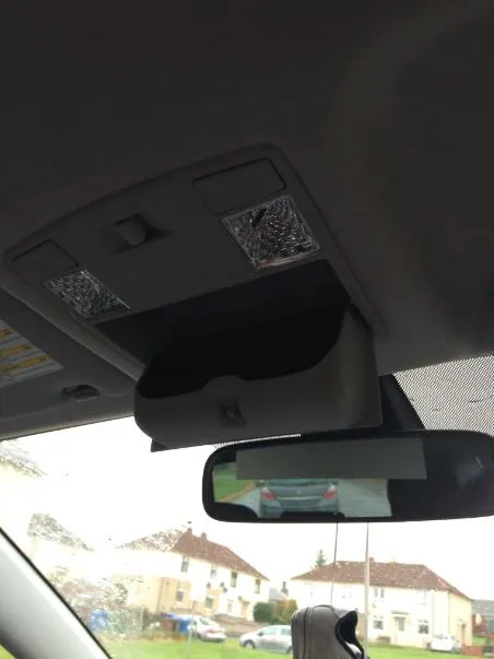

Well that's interesting. I wonder if it's a different part from the Mazda6 console or if the headliner is cut differently...
