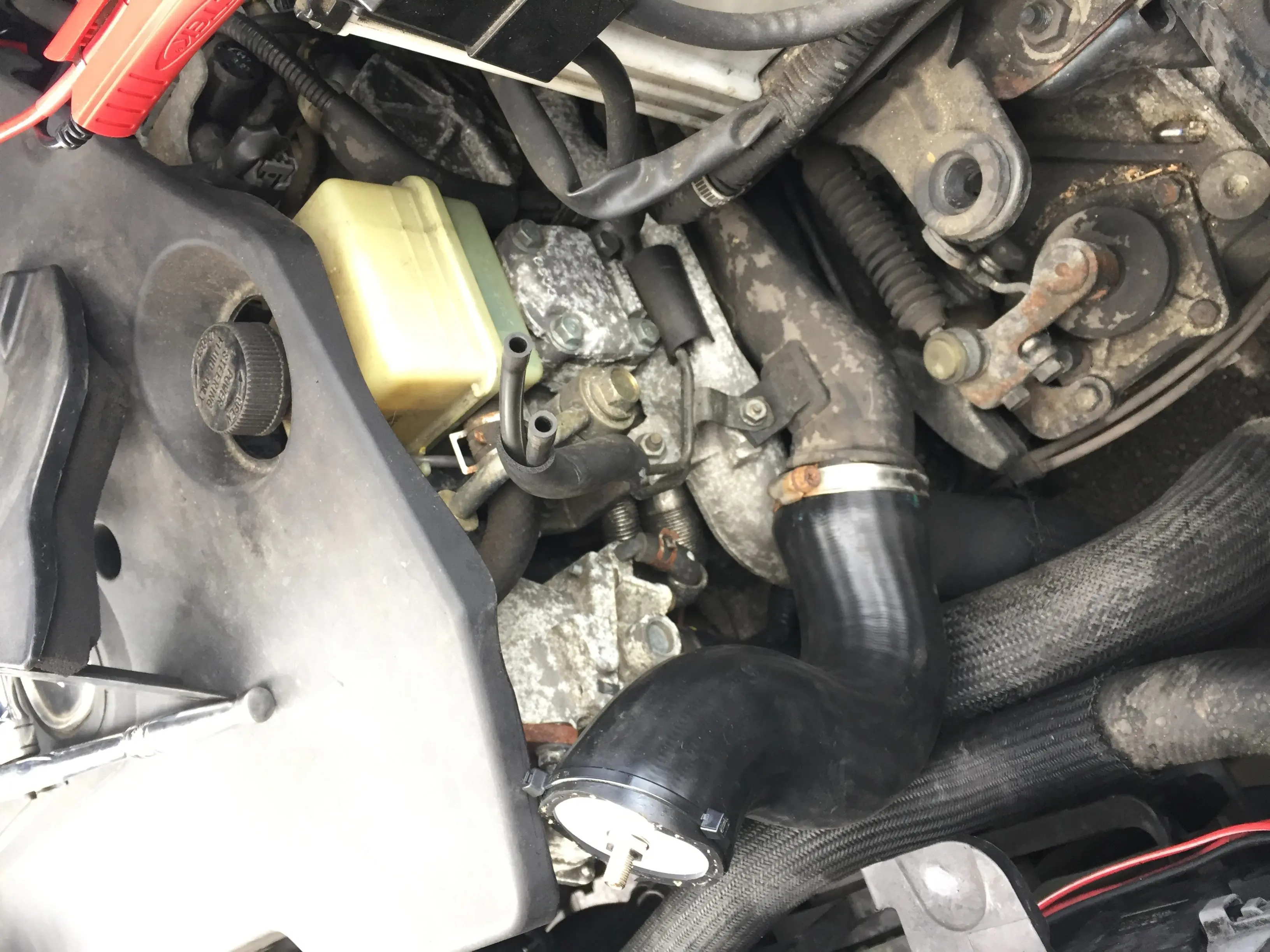

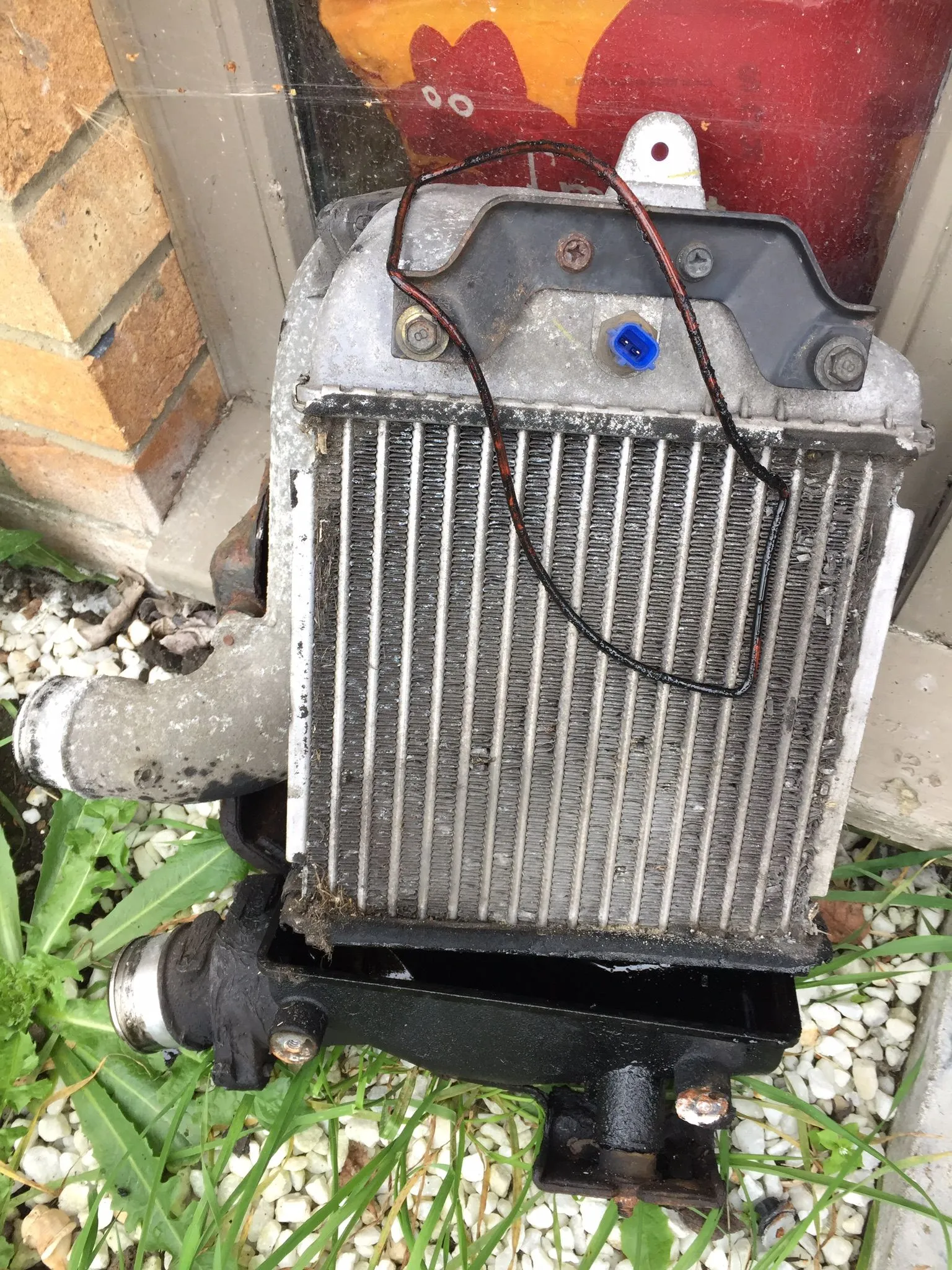

I also had a split intercooler that was giving a boost leak afterwards that eventually popped open believe it of now. once i replaces the intercooler o pressurised the intake system using this cool little contraption - a bit of boost hose with som turnt nylon to fit the end with a schrader valve so it can be pumped from digital tyre inflator. i pumped up to around 6 PSI, listened for any hissing (couldnt hear any) and watched the digital gauge for about a minute to see if it went down which it didnt.
PS i had also removed the DPF too and
mapped it out myself.
