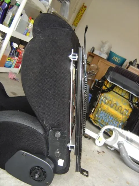

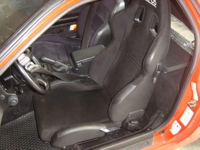

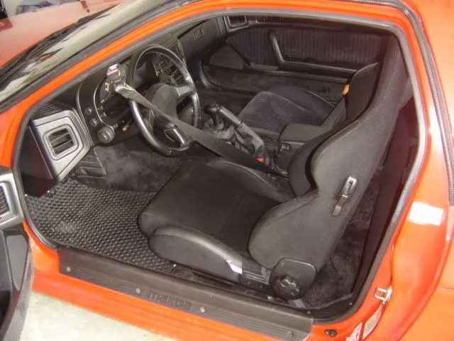

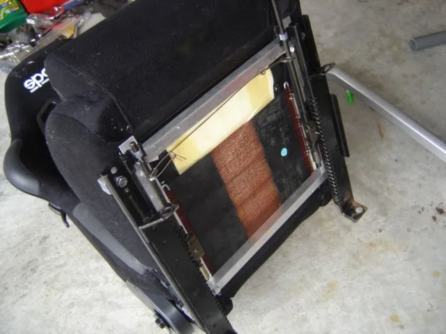

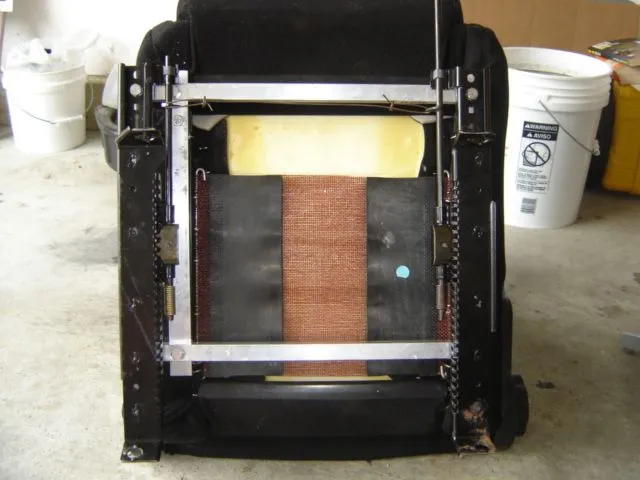

Starting working on making a bracket for the driver's side Sparco seat. I've got everything cut and drilled, just need to pick up some longer bolts to get everything together. The one thing I'm worried about is my initial test fit was showing the seat being slight too wide for the car. I've made a couple of changes to my initial design so hopefully everything will line up.
I was able to fab up (and I use that phrase loosely) some brackets for the driver's side this weekend. I ended up using the stock brackets and aluminum stock found at Lowes. Initially I used some 3/4" square tubing and some 1/8"x1" flat stock and while that worked, I found the seating position to be too high (knees hit the steering wheel and head hit the roof at times). I went back to Lowes and picked up some 1/4"x1" flat stock and that did the trick (needed to be thick enough to clear some features on the stock slider).
I'll let the pictures do the talking. The pictures show the 3/4" square tubing initially used, but the end product is essentially the same. Total cost for the driver's side: ~$35. Take that $110/ea Wedge brackets!

Wow, your interior looks fresh! Looks like it's in crazy good shape...
The sad part is it's incredibly dirty in those pictures!
It was already in decent condition when I got it, but I replaced every (visibly) broken panel last Fall. There is a burn mark on the radio surround from the cig ligher (argh!) and the steering wheel and e-brake handle are showing some wear and the cargo cover isn't perfect though. I'm going to get a new radio surround and the steering wheel will be replaced with a slightly smaller Sparco one(350mm) and a Snap-Off quick release unit; I don't know what to do about the e-brake handle.

For 20 yrs old... That's in excellent condition; one of the best stock interiors I've seen. O, & quick release wheels, ftw!
