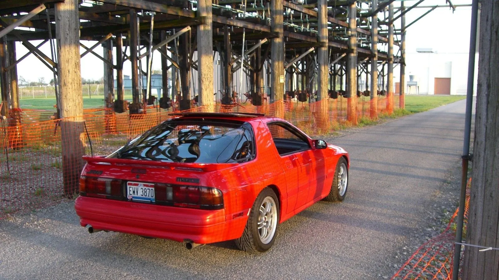

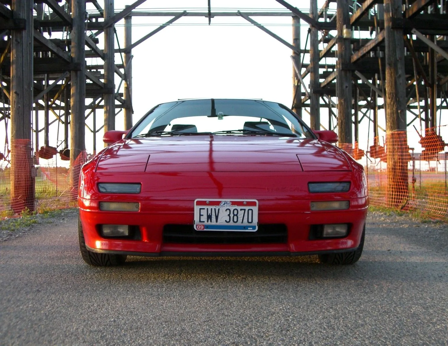

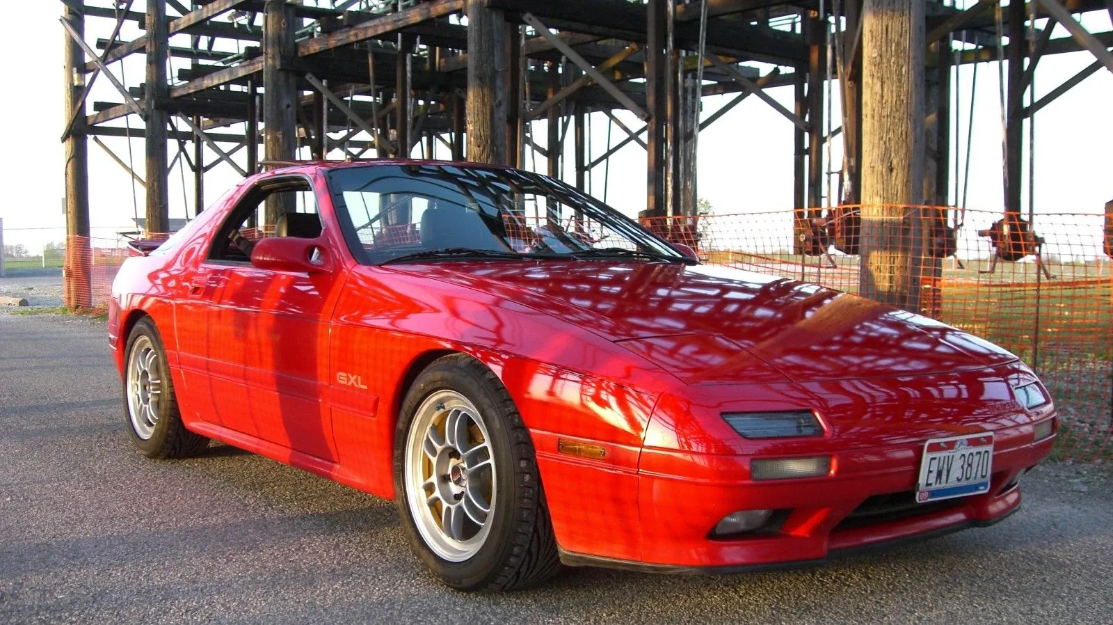

So I just realized I haven't posted any updated pictures of the car in this thread. These are actually a little outdated (middle of April) but the only noticeable difference is the Sparco Torino II seat on the driver's side (not pictured); everything else is just brake work.
Attaching pictures because they are large!

Awesome! Man those tires are freakin beefy, lol. Crazy how much beefier a 225/50R16 is vs a 225/45R16... Lookin forward to test fittin those! ;)
You know, I originally wanted 245/45R16's on there, but after test fitting some 225/50R16's I didn't think it would be possible, which is strange because I have seen that exact combination on another car. The concern is the clearance between the spring perch and the tire in the front, the rears would be fine. When these tires wear out I may just buy two 245's and check the fitment up front.
