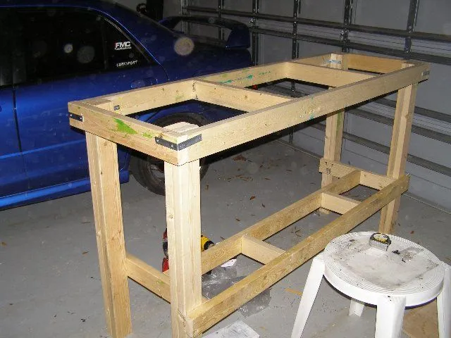

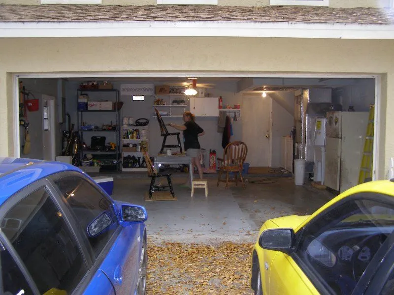

So since You cant find any decent quality workbenches for a decent price in lowes/home depot I decided to make my own. I used 7 10ft 2x4, some screws and corner braces. Its not finished yet, I still have to cut the top for the table and the top for the shelf. I'll be using some inch thick plywood to make these. I'm also thinging Im gonna trim the legs about 3 inches all around because as it stands now its 43 inches high lol. Its also 6 feet long and 2 feet deep. Plenty of room for future projects. It will be going along the left side wall of the garage pic.
Tell me what you think and what I might be able to do to make it better since this is my first workbench.
Post your own if you've done the same :)

The bench certainly has the makings of a sturdy work center. I would have made some different decisions about the contruction however. Here's my $0.02:
1. I would have cut one of the 2x4s that make-up each leg shorter so that the long cross member rested on it. The other would extend to the top of that cross member.
2. I would place a diagonal along the back to keep the thing stable left-to-right. The lack of a real joint between the legs and top, or substancial hardward at the joint, leaves open the possibility to sideways movement.
3. If you're going to have this in one place for ever, you may want to screw the top of it to the wall. This might be over kill but it would really prevent movement and shifting.
yeah, I was definitely plannin on mounting it to the wall w/ some Tapcons. And I was thinking of doing a diagonal brace along the back like you said, so now I think I will hehe.
Thanks for the suggestions (2thumbs)
All in all, not a bad start for under $50 :D

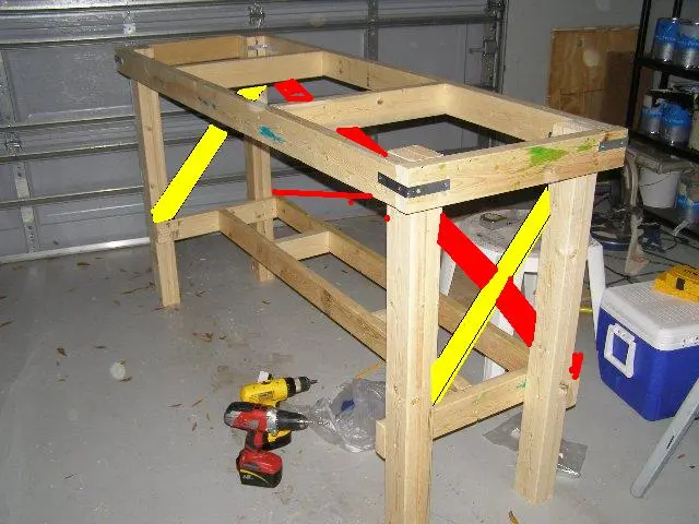

here is what I would suggest.
buy one or two more 2x4's and brace the legs.
What are your plans for the table top?

clean that refrigertaor up in the gagrage.....and sweep those leaves before they blow into the garage...lol
bench looks good....are you going to paint it or stain the wood?
yeah, I'm thinking Im going to do that now :)
as far as the table top for now it will have to be just ply wood...although I was thinking of getting a piece of sheet metal to cover it.

lol the beer fridge has character tho...and no beer right now (boom07) but I was gonna sand it down and rattlecan it.... hehe
and the leaves are already gone :p
