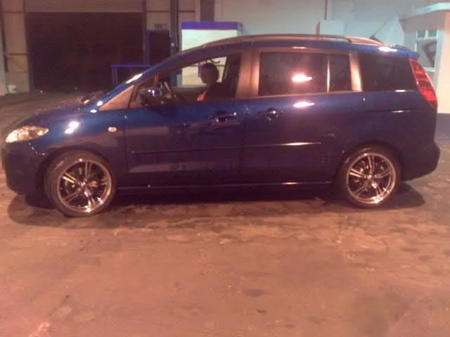

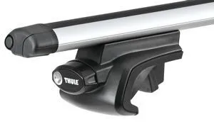

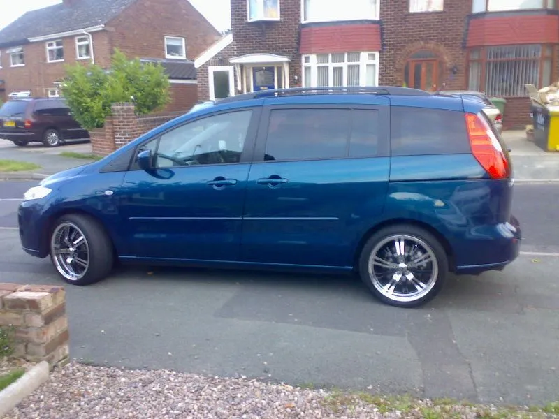

North American M5's do not come with roof rails (not Canada, Mexico or in the states) but we have that roof track where you can attach clips for Yakima or Thule...
But the UK M5's some standard with roof rails. My wife and I are trying to figure out how to get their roof rails onto our Mazda5. Once we have roof rails, then we can attach the Thule or Yakima attachments w/ cross bars.
Any ideas? See below.
