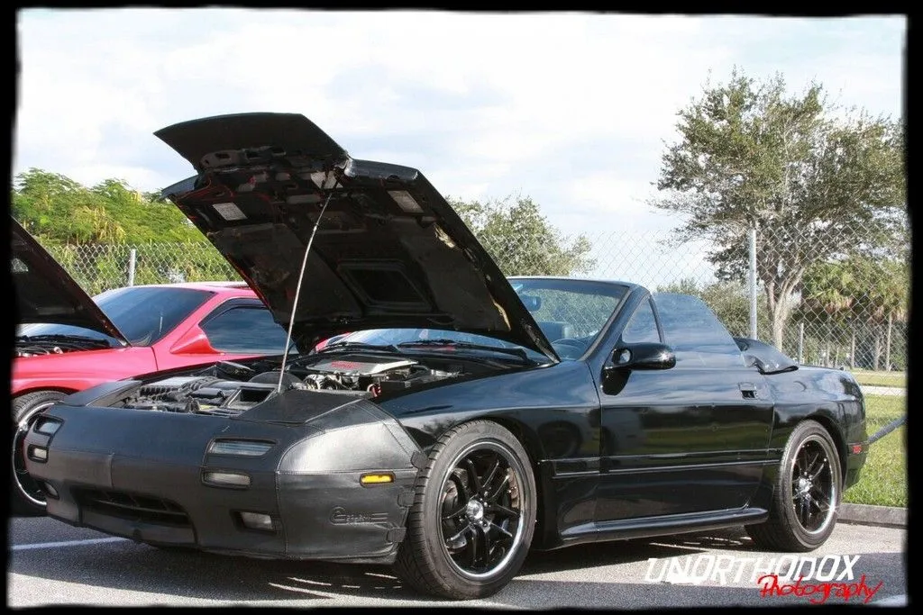

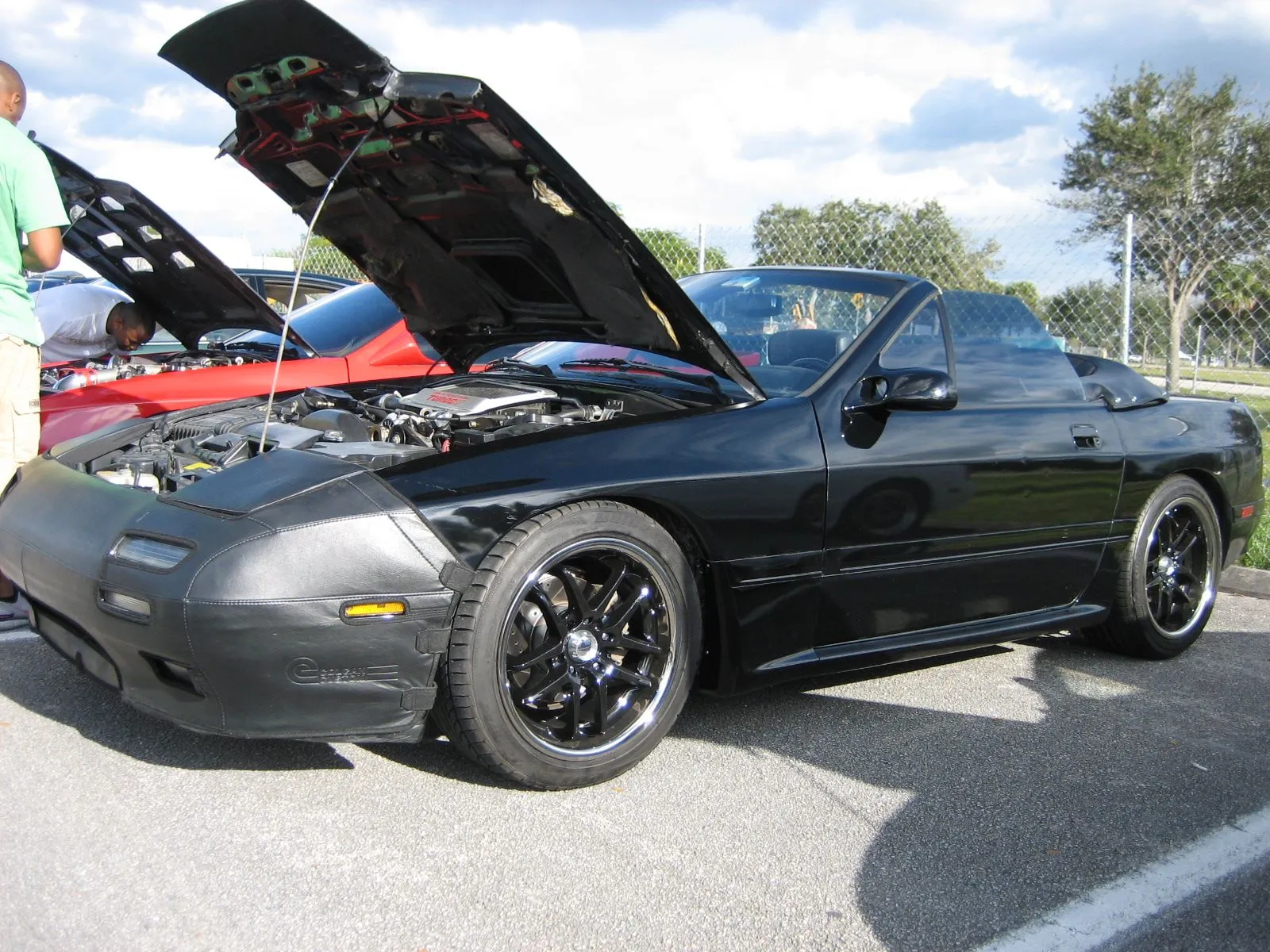

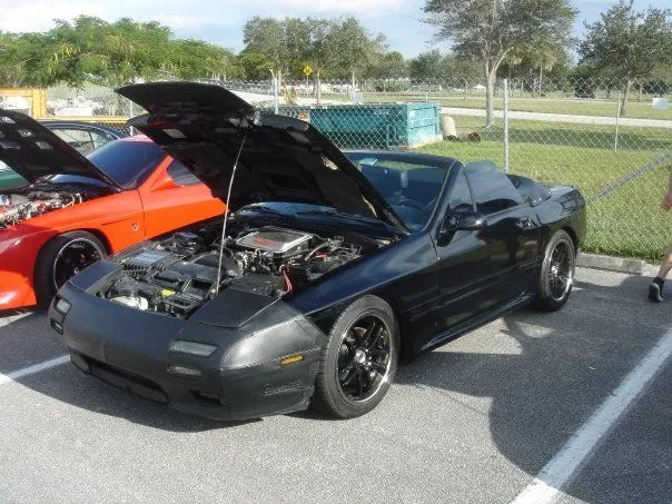

Here are some pics of the car at a rotary meet here in S.Florida. I've recently added some 17s and turbo side skirts.
