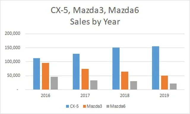

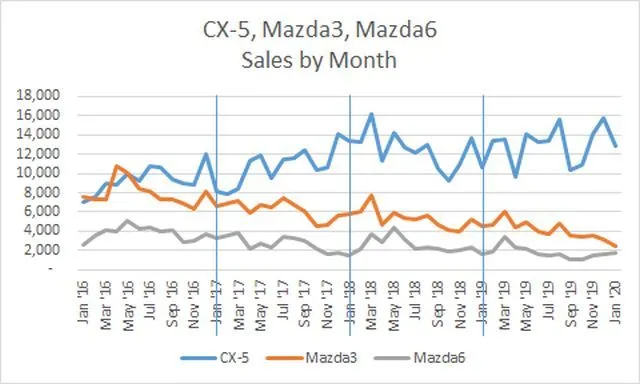

Those are interesting comments from your dealer. So I went and grabbed some data.
Keep in mind that this is the trend for all US vehicle sales:
>SUVs and Trucks increase
>Passenger Cars decline
I sure would like to find CX-5 NA vs CX-5 turbo sales.
