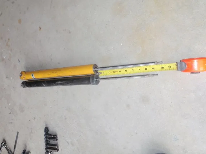

I was reinstalling my stock rear shocks today and noticed that the koni yellow that I was taking off were about an inch longer than the stock ones. Has anybody noticed this? I am just curious since I have had all sorts of handling issues with my koni yellow on the rear of my car, well not so much handling, but ride quality and noise issues. I still have the koni on the front and like them there, but I couldn't get them balanced decent on the rear. Take a look at the pics and let me know what ya think.

They're not really longer when installed... there's just as much shock travel as with the stockers -- it just looks like the Yellows will have more preload. Nothing wrong with that..
