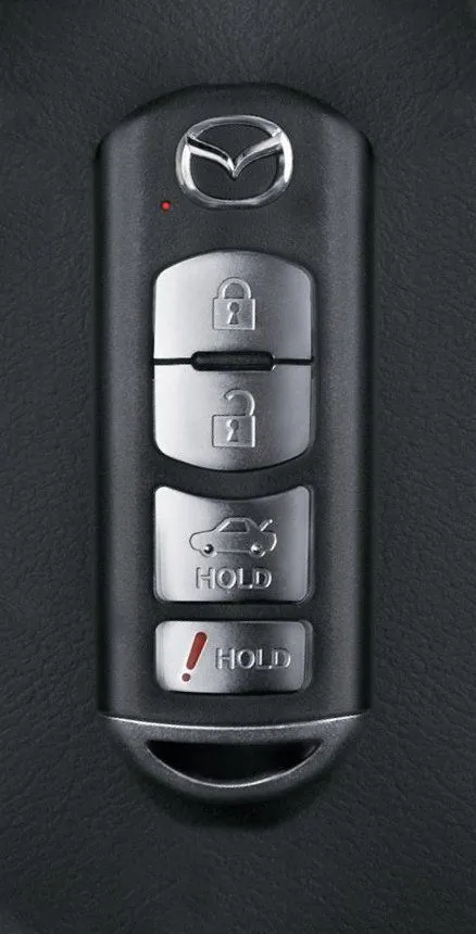

Nope. MUCH nicer for 2010.
Apparently a lot more range, too.
The new remote looks nice.
How long is it?
By range, you meant the push-button range or SmartAccess range?
