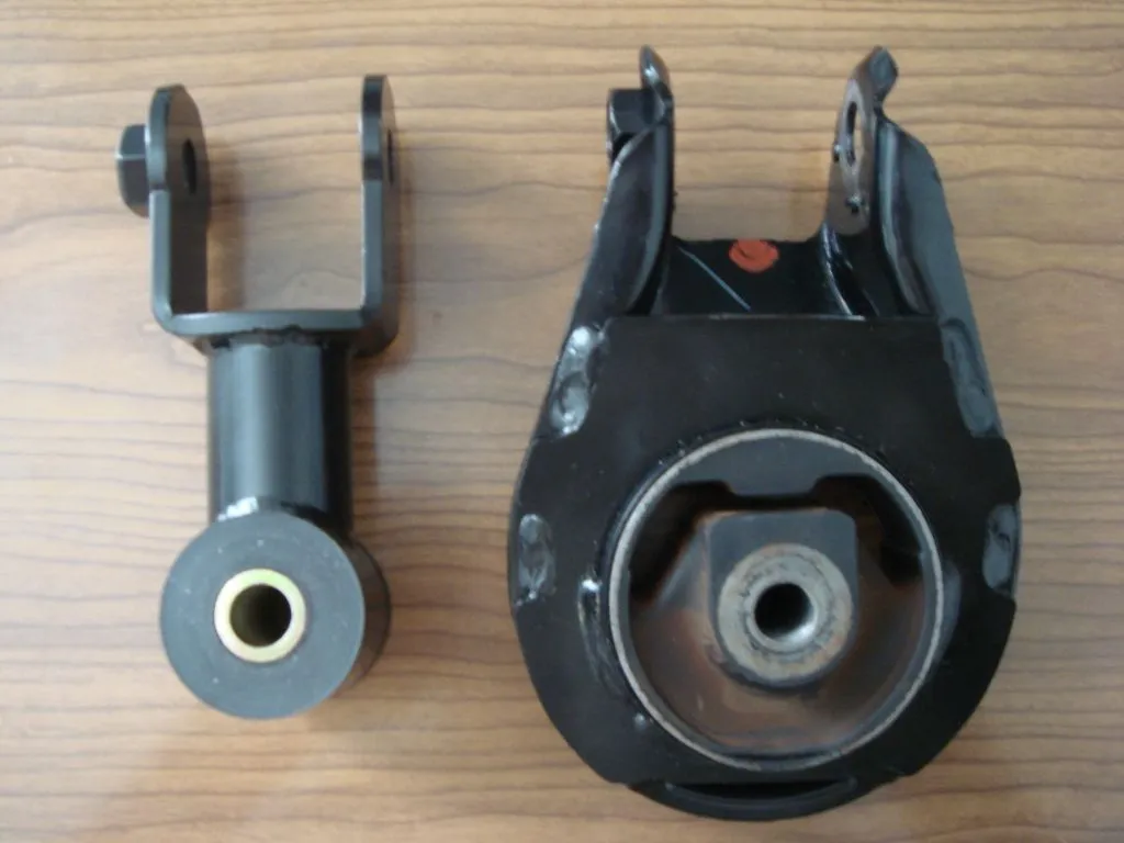

Just installed my TRZ Dogbone Poly!!
I just installed my TRZ Dogbone Poly engine mount this morning.
It was the easiest install I have ever done...other than upgrading a shift knob... (lol2)
Literally, jack up the car, remove two bolts, wiggle out the OEM engine mount out by rocking the engine forward (this hands) and install the Dogbone. Thats it!!!!
Word of caution though, according to the service manual you have to torque the frame bolt first and then the tranny/engine bolt second to avoid any vibrations...
Man, the OEM engine mount is SOFT!!!! I can see why the engine rocks so much!!!
When I started the car to move it back into the garage it vibed like crazy, I thought I was in a go-cart or race car... Its supposed to break in after a few miles... We'll see!!
I'm going out to test drive it now!!!!

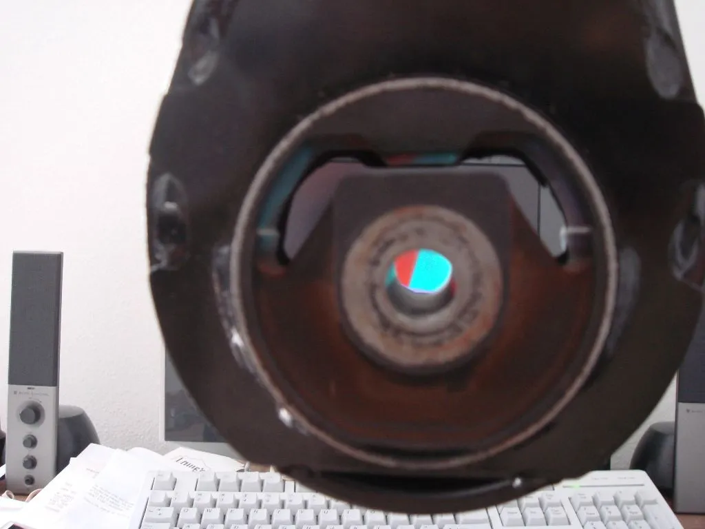

Looks to me like a motor mount insert would fit into that soft mount and cure alot of the issues without haveing to replace the entire mount. I just dont think anyone has made one yet. BTW a motormount insert would press into the open area of the oem mount making it like a solid one but not quite so that it would still allow some play so that the car wont shake. energy suspension made a kit like that for my old GTI i had and it works great. i wonder if they are making one soon for our cars??
corksport makes inserts for the mount, only $35 too

If you want stock like vibes (or lack thereof) but still want reduced engine movement and wheel hop you might give the corksport inserts a shot. I am happy with them. Not for all out performance like what you got, but the tradeoff is worth it to me.

Try the delrin mount ;)
Polyurethane is for wussies!!
jk, but seriously though, after driving it for a bit you will A) get used to the vibs and B) they will start to dissappear so no worries, and I promise if you go back to your stock mount you'll miss the stiffer mount. I've switched back and forth like 5 or 6 times now.
i have the derlin and maybe im use to it, but i dont really notice it anymore.
