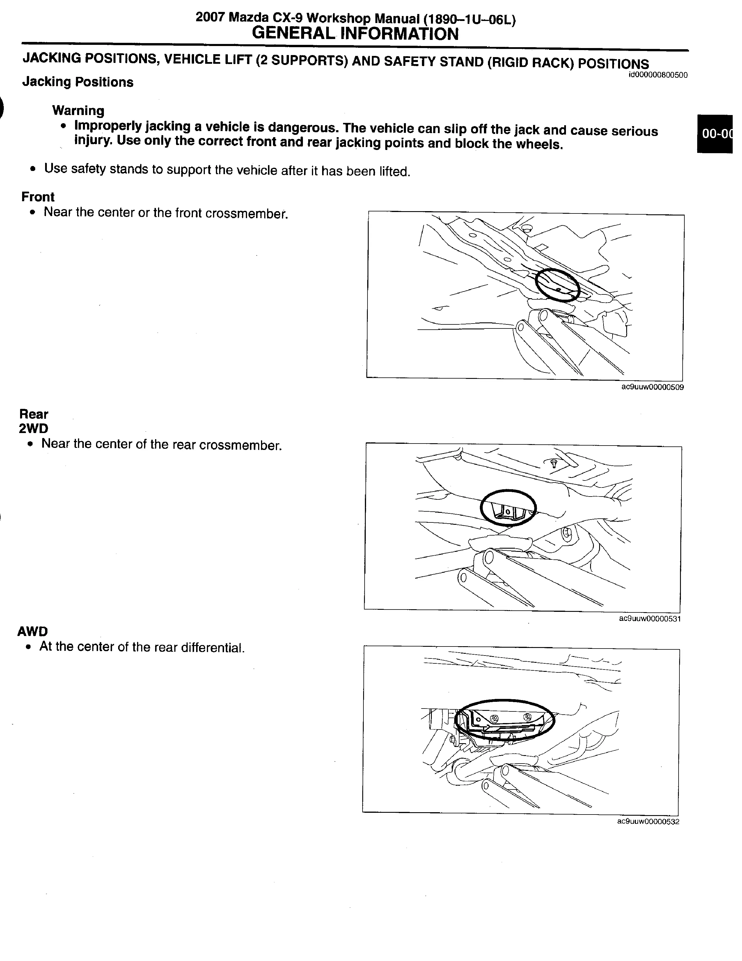

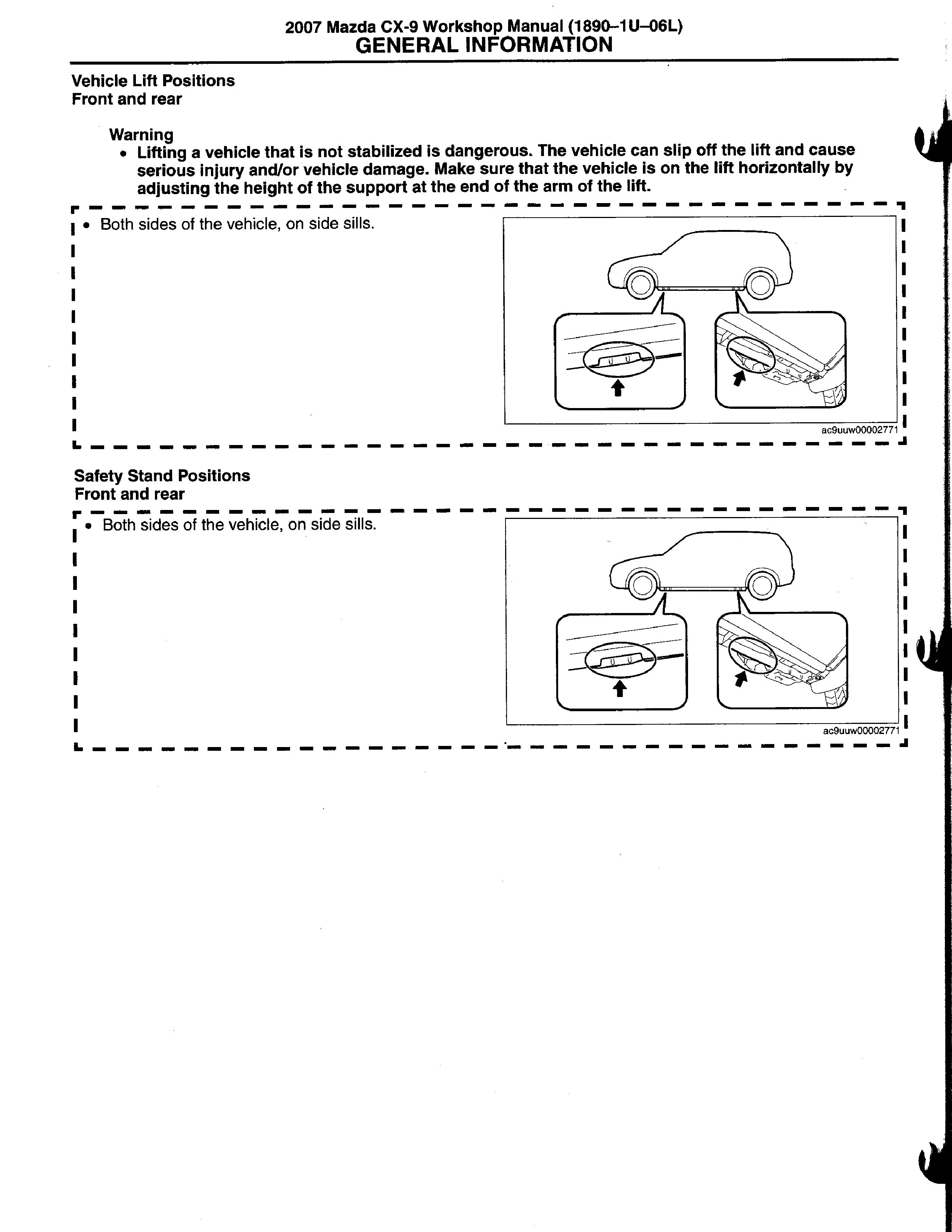

It's unfortunate that the last post on this topic was so non-constructive. However, I think the actual info is useful to have online. Be warned that all info in my post is with regard to 2007 CX-9 and may be different for later years.
The CX-9 owner manual defines the 4 side jacking points for the Mazda jack. It does not define the central jack points for a hydraulic jack, but the service manual does. Please see attachment for both, from the 2007 CX-9 service manual.

Now that I've gotten the CX-9 I'm going to be buying a better hydraulic floor jack, but I'd like to better understand the jacking points and procedure. The owner's manual shows the jacking points next to each wheel, but those probably won't work for a hydraulic jack. Lexx's post shows additional jacking points for a hydraulic jack, but that is for a 2007 CX-9 and I can't exactly make out what it is showing.

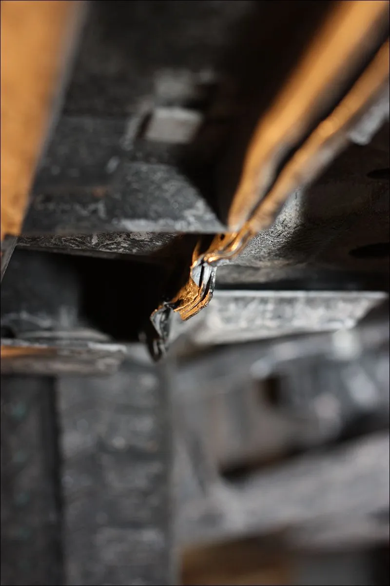

Wish I'd read this post before jacking up my car tonight! I ended up putting my hydraulic jack on the side jacking point and now it's bent:
attachment.php

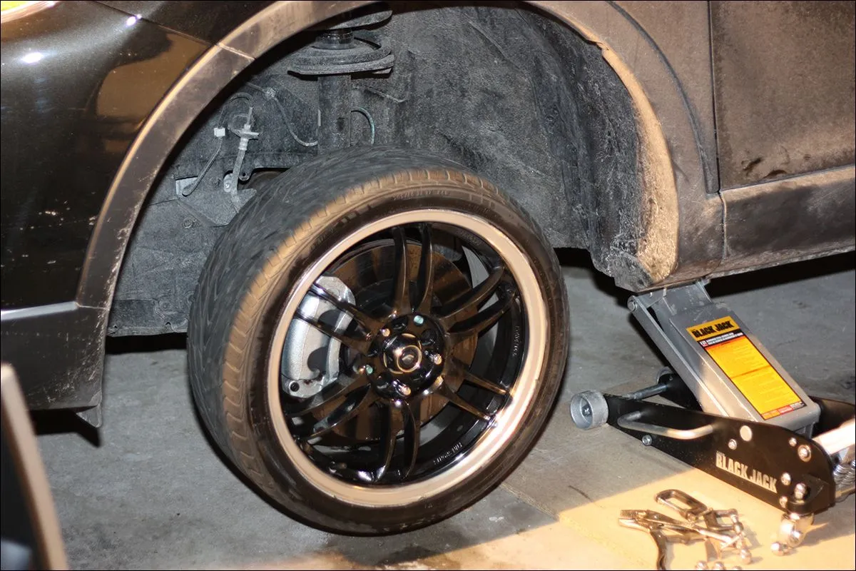

I was testing to see if my old Fast Inferno 17" wheels from my Protege would fit the CX-9 so I can use them as winter wheels. This just looks too funny with the Protege tire size:
attachment.php
