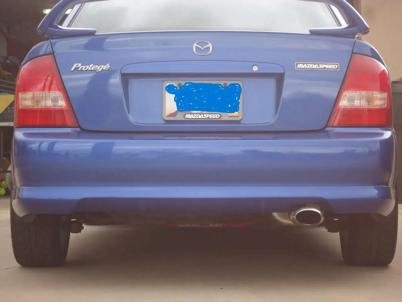

Got the rear spacers machined to proper size and mounted. Rear view and did note that excess weight in the back may require fender rolling. Thanks for all the input/replies.
