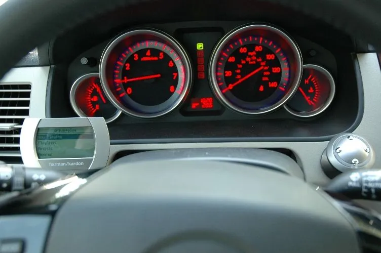

Mostly, what the H/K D+P offers is safety / convenience. If you're OK with picking up your iPod and scrolling while you're driving (or if you're one of the few that only does this while not moving) then there's really nothing to be gained from the H/K.
But since I didn't want my iPod sliding around, I didn't want to stick an iPod mount somewhere on the dash, and I didn't want a cord long enough to plug into the Aux and still have the iPod in line of sight, I opted for the H/K.
My iPod is stashed in the center console along with the H/K connections module. The H/K controller is just to the right of the steering wheel, and the display is just to the left. Nothing moves, I can find and use the controller without looking, and I need only glance down at the display (just like any of the rest of the guages). It's much more convenient, it's safer, and it's a nice clean install.
It's a bit of an effort to do the install (involves popping off a few dash panels), but for me it was well worth the effort.
