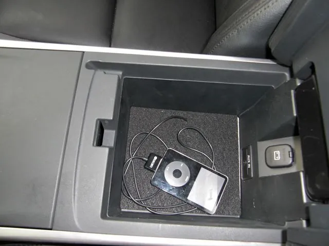

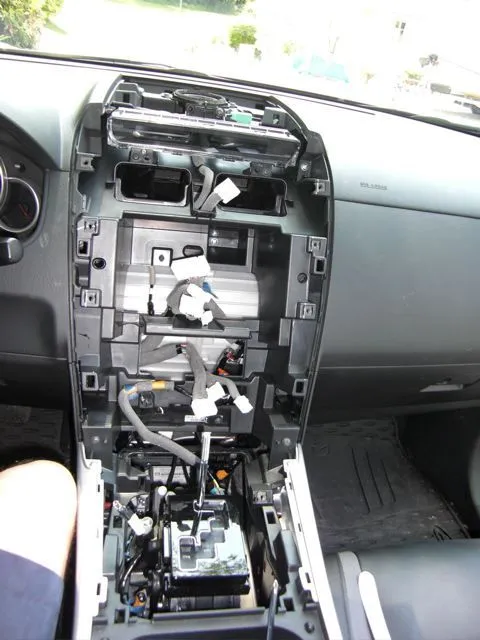

I finally installed the Dice ipod controller. I did a custom install as I wanted the unit and my ipod to live inside the center console. As someone pointed out earlier, there is not much room in the console under the storage box due to the A/C vents. Therefore my solution was to dremel out a hole in the storage box floor, sit the Dice unit inside the hole, and then build a false floor that sits 1/4 inch higher than the old floor since the Dice unit wouldn't sit low enough to clear the storage box. Not an ideal solution as I had to cut through plastic, but since I own the CX-9 and don't lease it, I can do stuff like this. The end result is, the system is totally invisible, and it sounds great. Tracks are very hard to select accurately however as you have to hold the button on the steering wheel for a period of time. Too short and the Dice changes modes. Too long and it will skip past 2 or 3 songs. I am going to call the company to see if they can improve this.
I am still satisfied, as my main goal was to have a way to keep the iPod charged inside the car and to see the track names on the NAV screen. The sound is perfect too. In fact I burned a CD of a playlist and the CD sounds worse than the iPod playing through the Dice.
I recommend this product over the standard AUX input. However it is not perfect, and the install took about 3 hours and it looked pretty scary. I did take pics all the way through and I will build a DIY web page if anyone is truly interested in doing this install on their own CX-9. For now, below I have attached a before and after.
