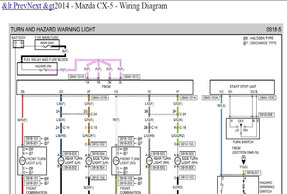

but the problem is nobody knows where the flasher relay is if there's one in CX-5!
Maybe, we should follow the clicker sound, to find it.
The clicking sound of turn signal is from audio speakers as its volume is adjustable. I suspect the flashing function is handled by one of the many electronic modules with audio system and there's no traditional electro-mechanical flasher relay. That's why Mazda hasn't changed the turn-signals to LEDs like almost everything else on lightings, including the latest 2nd-gen CX-9, as the change is involved more than just replacing a LED compatible flasher relay.
Correct, it's controlled by the body control module.
