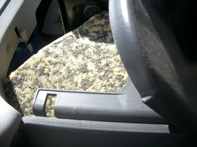

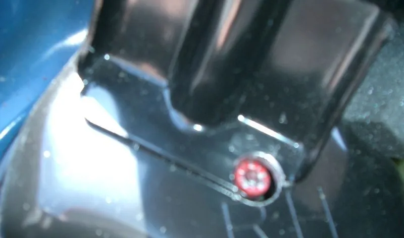

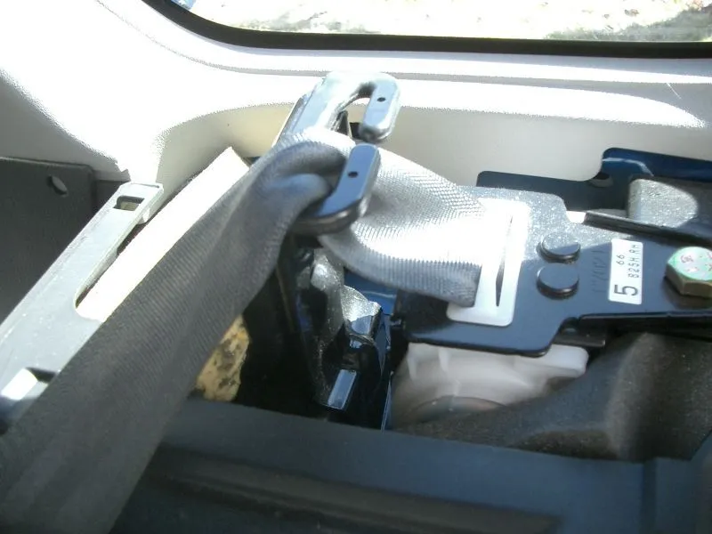

im doing my struts at 11:00 today can any plz post a pic of the location for the strut adjusting hole i need to drill.
If it's not too late. Here's the pics. Lift the plastic, pull out the foam, drill the hole.
