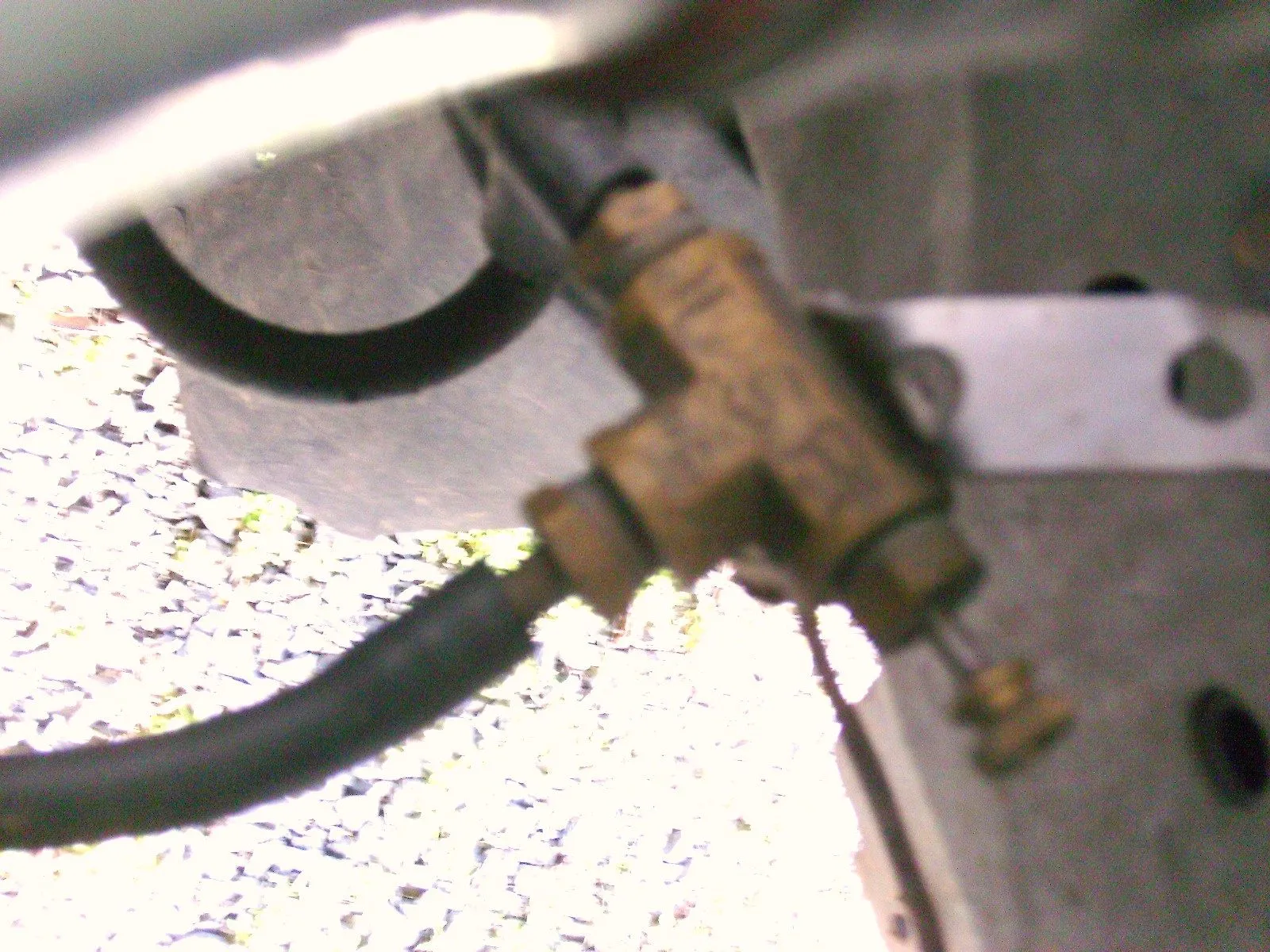

I think I just found A Manual boost controller???
on/off switch??? is there power running to it? I would follow the wiring and find out what the **** it connects too!!!
While wrenching under my car I found clips, that seem to have held neons LOL
why anyone would add neons to an already bright ass car amazes me LOL
It seems that what ever had been added to the car was properly removed and placed back to stock properly, there was no proof of anything else anywhere on the car, we couldn't even find where the lights were connected
Yeah my dimmer switch there just relocated. I still gotta upload pics but the switch isnt getting power i found that out but theres a whole set oh other wires hooked to a power outlet under the hood. Looked like it was powering his fogs and some neon like you found. Im sure the wires wont hurt anything but it looks terrible and sucks its not even powering anything. I picked up a cheap sunpro today whats up with that narrow tubing?? did u use that or some 3/16
They use that for the boost to follow. The smaller the tube the faster the signal can reach the cockpit. It takes less time to either fill up or suck down the tube if its a smaller diameter.
Ok got my guage hooked up vacuum sitting at 21,and boost around 7.5 to 8. Just i fair guess which way are most Mbc clockwise for decrease and counter for increase its not labeled on mine.
ok ill give it a shot and see what i get. You still in Gboro? im bout 30 min away in Pelham,NC(probally not on the map lol)
Ok Ive done test after test and im sure the boost is set to 9 or 10 and its around 30 degrees in the carolinas right now and the fuel cut is terrible everytime i get close to 9 and 10 it cuts. And i dont want to adjust the controller the wrong way I just want to put my own on. so heres another pic. When i uninstall do i just disconnect and put in a striaght fitting is it that simple?

I would just replace the whole VAC line that way there is not a straight through that might cause a vac leak.
does that fuel cut feel like your hitting a wall??? If so your WGA might need to be replaced. ATP or Forge are the only options. Just run a whole solid new vac line safer that way
