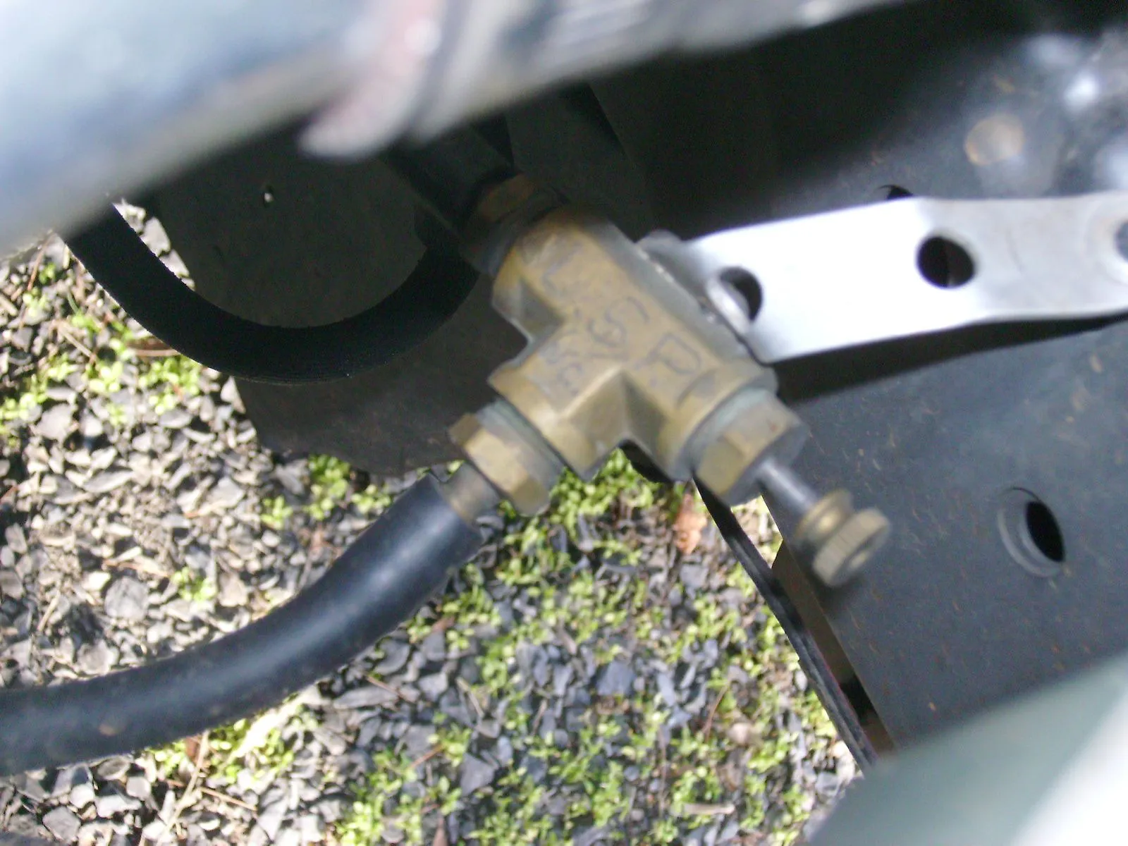

I kept finding things as i look closer at my new MSP, I think i just found a MBC it has LSP labeled on it, I've never even heard of that. The tail hole i got it from snatched his boost gauge so idk what im pushing. Let me know do i need a new MBC or just install the gauge.

wouldn't boost till you get a guage best deal remove mbc and put straight fitting in case you do. you should be at around 5psi no more then 8 with out takeing a risk of going boom.
is it attached to your wga?
if it is it's a mbc if not where is it attached to?
yea its attached to my wga, so best bet is to remove and straight fit the two lines connected to it? But if i leave it whats the harms and would adding a boost gauge help read to boost. and in your first reply what did you mean by it wouldnt boost, "the controller or car itself" thanks for the help youre saving me alot a headache's thanks man.
what he is saying is for you not to allow the car to go into boost until you know how high the boost is set on that MBC. Boost to high and your motor goes pop!!!.

The guy removed the Boost gauge. What else was removed before purchase that was helping maintain motor safety. Was there some sort of EMS that was tuned to boost 12 psi??? now that gone but he forgot to take the MBC out too.
Just pick up a cheap sunpro boost gauge from pepboys like $30.00 so you at least know where your at boost wise

got it guys thanks for the help, you may have saved my engine. I'll go pick up my gauge and post readings.
Which ever way I go I know i need that gauge which would be a good source(line) to attach the gauge to???
On top of the Intake mani. (its the one most people use at first before they have a block in their break booster)
There is a thread in the How to on building your own Vac block by using Mcmaster parts. Or you can just buy one. Either way. Run your WGA, BOV/BPV, and Boost gauge all off the same line on the brake booster...write up also found in the how too. If you eventaully or already have EMS connect that to the vac block as well that way everything is running off the same solid line and seeing the smae pressures!!! Best and safest practice.

i'd go with a quality boost gauge, a cheapo can be off a couple PSI. unless a few people can vouch for the accuracy of a cheap gauge.
if your not going the vac block route, a good source is the fuel pressure regulator line. but tap the line at the back of the manifold between the manifold and the FPR solenoid.

I'm running a sunpro at the moment and it reads pretty accurate to what my Split Second reads. It was a great cheap temp. fix. I've run Sunpro in all my off-road rigs without any issues, I can state for a fact they are can take abuse.
