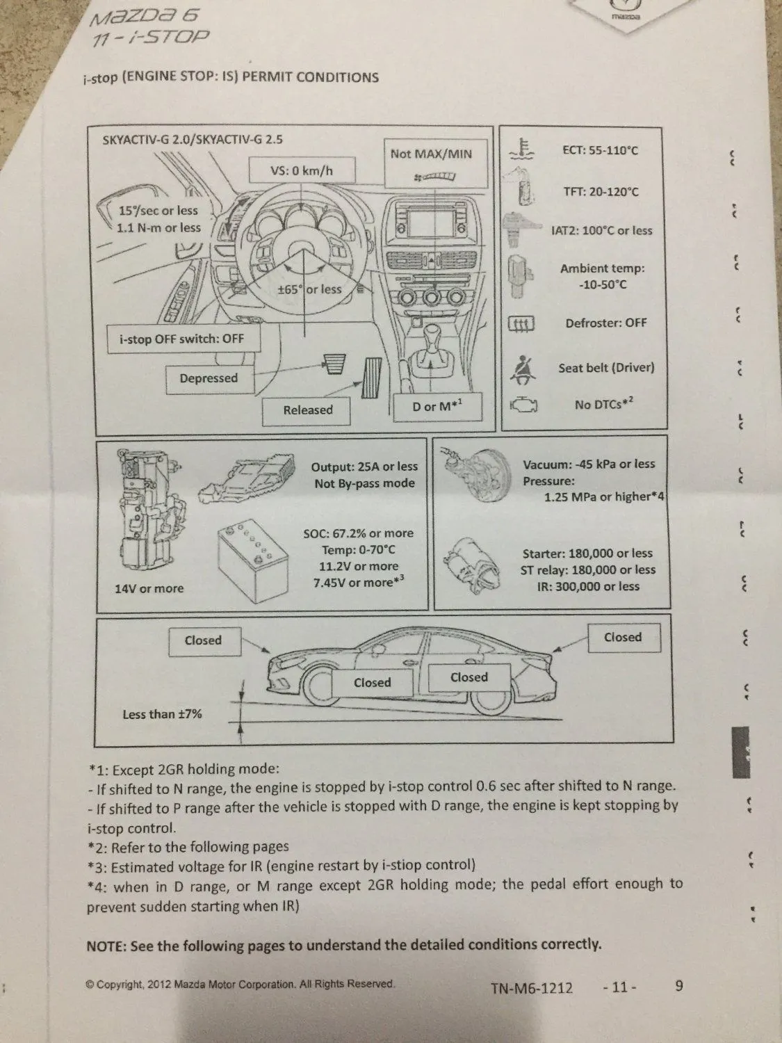

Here's the complete list of parameters to be met for iStop to activate.
If iStop works after a reset and stop working after a while, it could mean one of the external parameters are not met, or there's a DTC (diagnostic trouble code) error. It could be some failed sensor or emissions system issue. Get the dealer to check what is the code and rectify the issue. You could probably go to the Infotainment screen, under Applications, Vehicle Status Monitor to check for any errors that might show up there.
You can reset it at home - the easiest way is to disconnect the battery negative lead for half an hour*. If you also ensure the battery is fully charged using a smart charger designed for EFB batteries, it should start working again after a mile or two. A new battery is not usually necessary. The ECU measures various attributes of the battery (more than just voltage - it tries to determine internal resistance and other measures of condition) and the blue halo will not illuminate if it is unhappy. Sometimes the ECU just gets it wrong and "condemns" the battery wrongly, then the blue halo will disappear until a reset.
