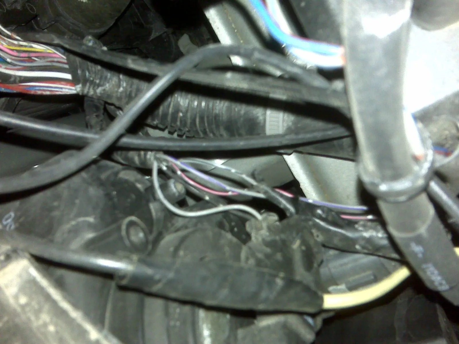

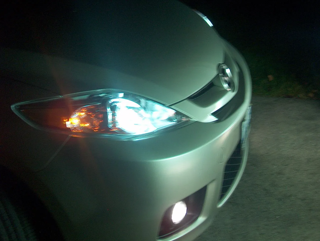

You do have to wire the HID's into the headlight wiring. Its not a plug and play, but its pretty easy once you know which wire to tap into. If you just plug them in, when they are running on DRL, the HID's will flicker and they can damage you ballast because the voltage is lower. To wire the headlights in to work off your auto headlights, purchase a relay kit. I bought mine off the Xenon store for 25 bucks. Use the wiring instructions that came with the kit.
The signal wire that you have to wire in has to be wired into the signal wire for your turn signal. It is the grey/black wire from the running lights.
There are three wires in the group, one pink/black, grey/purple and grey/black. Just splice in the signal wire. See picture attached.
This will run your HID's just like your regular auto headlights. You will not have DRL's. Have not had time to figure that out yet.(headbang)
