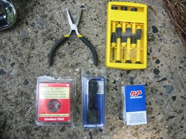

You will need:
1. pliers to crimp things with.
2. something to cut wire with
3. a wire stripper (not your teeth, rambo)
4. some mini screwdrivers are nice
5. 2x Sorenson MR78 relays
6. 2x H4 connectors. the ones I bought were crappy but seem to work.
You can see some of this stuff pictured here:

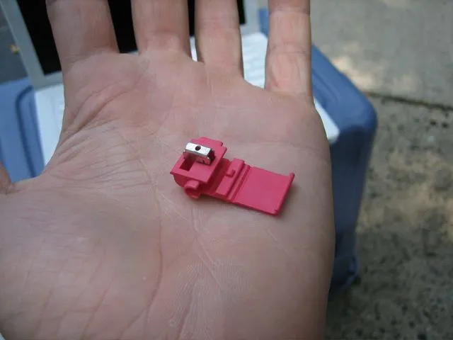

I also used these 3M splicer thingies pictured here, but I forgot where I got them. They are great for letting you not cut off the OEM connector and not destroy the wire to them but still get power spliced into them.

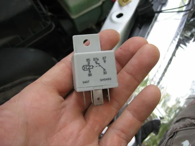

And here's the relay in question:

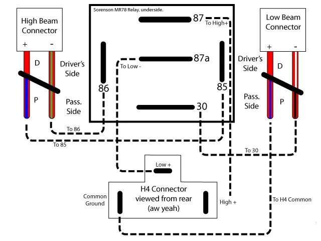

Here's a slightly more detailed drawing, based on thewrench's information that you may find helpful.

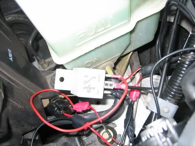

And here's what my sloppy finished product looks like on the driver's side.

I taped everything up to avoid having moisture problems, and hid it all away as best I could. On the driver's side I figured it was best not to have the relay and wires laying on the radiator hosts which are all around, and on the pass. side there is a pully and belt situation that it would be bad to have your wires get into.
So that's that! Now I have high beams and low beams in my MSP headlights on my Protege. Now to get the pesky Driver's side turn signals to work and I'm all good!

you need to get a relay socket dude! and that relay itself looks pretty weak... I'd get a beefy bosch 30 amp relay with socket if I were you
Good advice. but I went with the giant electrical tape ball option instead, 'cause that's how I roll. I'm pretty sure the mr78 is a 30-amp relay, though.
those small GM style relays tend to fail easily... if it ain't a big ass relay, the contacts in there aren't big and heavy duty!
30 amp relay:
Bosch part #0 332 204 150
Hella part # 960 388 07
Porter & Brumfield # VF4-45F11
What relay socket would you recommend?
Dang, I attempted this today and although it looked pretty simple, now the low beams do not work and there is only light when the high beams are on (though I am not sure if it is actually the high or low that is on). Any ideas?
Never mind. I paid $60 to have it fixed. They said that the diagram that I had a few wires backwards. At least it works now.
Did you wire it as the diagram listed above? Can you take a picture of the wire set up as it is now? That way the correct way can be shown.
Thanks!
