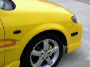

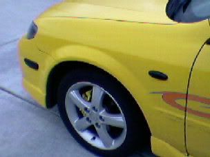

I just did this mod and there is an amazing appearance difference. I bought the VHT tint spray on ebay(its illegal and most places don't sell it) and did this after work, let it dry over night, and installed them the next morning before I went to work. Here are some pics of mine:
great job on the thread domaniam. you could have bullshitted your way through explaining this mod but you took the time to go into detail even though its an easy mod. So props to ya.

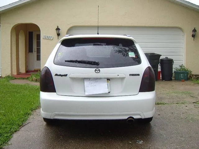

Here are pics of my tails after using niteshades. Very light coats i didn't want the really really dark look. In all honesty if you didn't know I used niteshades on them you prolly would not even notice that they were darker (even p5 owners). Light clear coats on them too but prolly could use a heavier coat to bring out more shine.
Before:
After:
