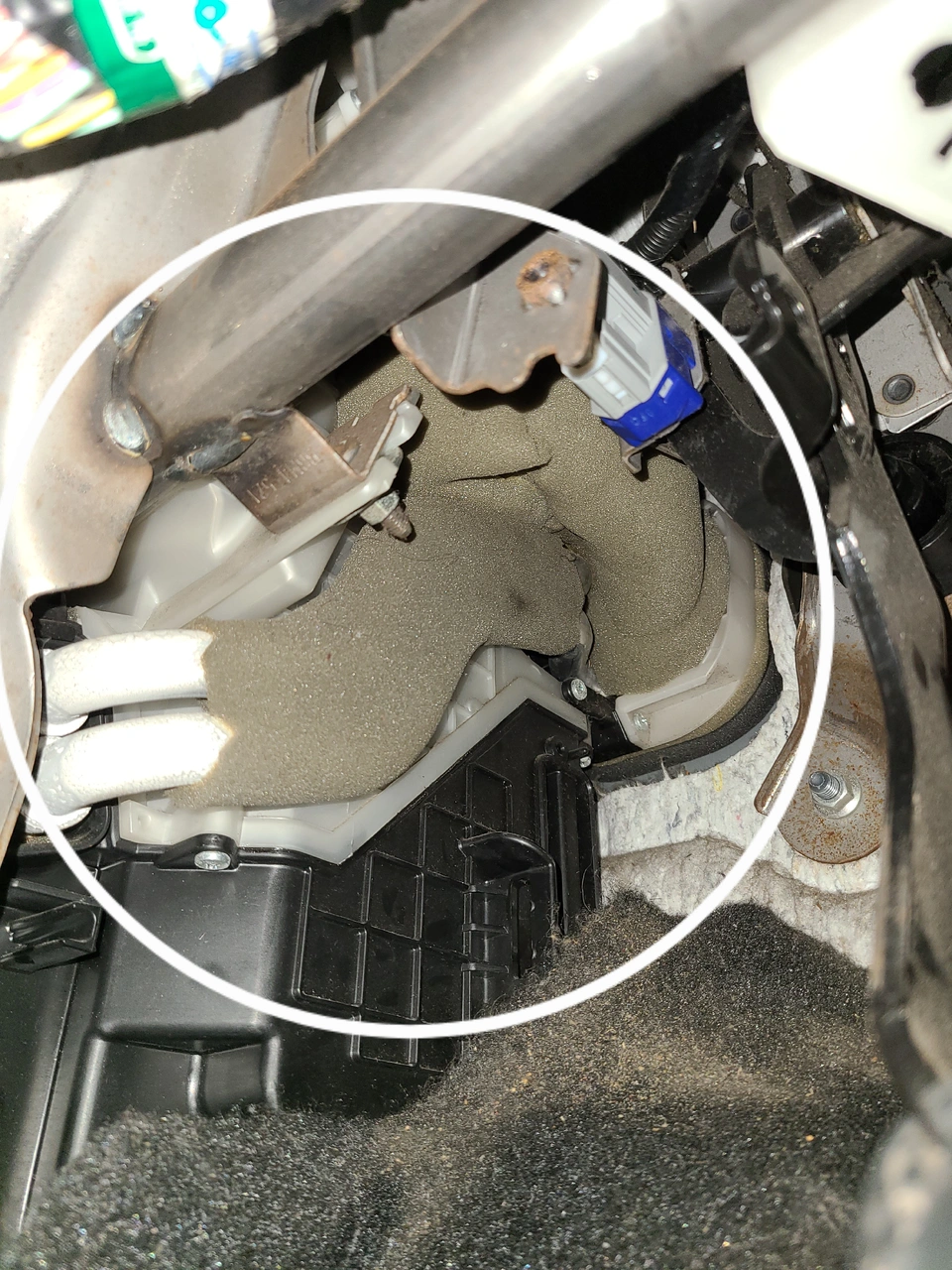

I've got a noisy blower motor and have gotten up to being able to look into it directly from the passenger side and can't see any leaves etc.
So watching a few youtube videos they then come around to the drivers side, and after unscrewing a few pieces, more or less are able to remove the blower motor.
Where I'm stuck is that on my one, there are a few small metal pipes all around that area that I'm not sure how to remove. I can't see too many screws and the video instructions I'm watching don't mention this..
So I'm not sure what to do next?
I think I'm ok to spend hours doing this, I have all the tools etc. But I just don't know what the proper instructions are for RHD.
Has anyone done this before that can help?

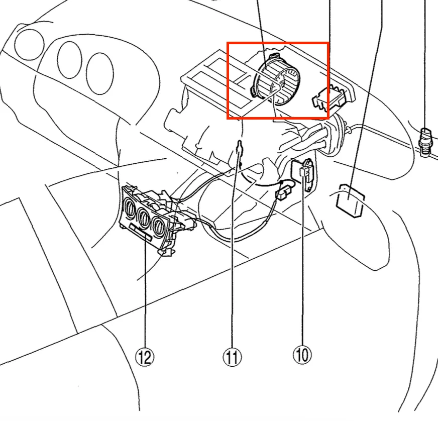

Is the blower motor not directly under the dash in the passenger side?
No, centered and deep within the dash. I have the manual (attached) but am hoping someone has done this job on a RHD without pulling out the whole dash, which seems to be the most common way, except for the LHD models apparently..
