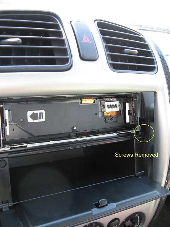

I apologize if someone has already described this in detail, but i've been searching the forum for hours and have messed around in my car with no luck.
I cannot figure out how to get the stock Kenwood (KDC-MP919) piece of crap deck out of my MSP.
I recently had the "no-display" later followed by the "stuck half-way down faceplate" issues. I've done a lot of my own deck replacements on vehicles in the past, but I can't quire figure this one out.
So, so far I've removed the trim. It's tight at the bottom where the climate control cables are at their limit. I saw the 2 screws on either side and below of the deck and loosened those off (shown in yellow on thumbnail pic). I thought I would just be able to slide the deck and/or the entire mounting bracket (with lower tray) out from there. But no-go. It's stuck. What am I missing? Can anyone please provide a detailed description?
Is this one of those jobs that everybody gets the audio retailer/installer to do for them?
Any help and pictures would be greatly appreciated!

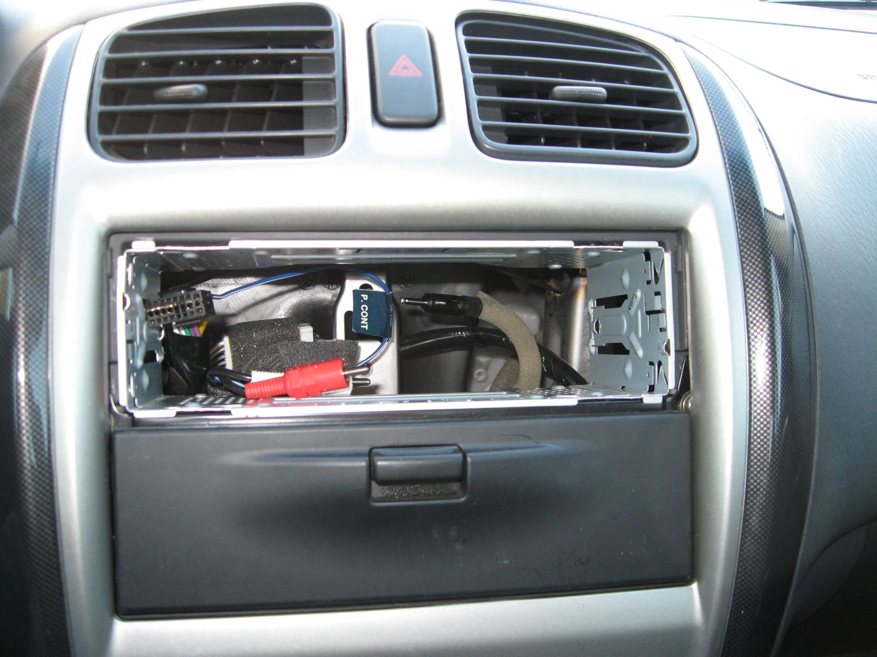

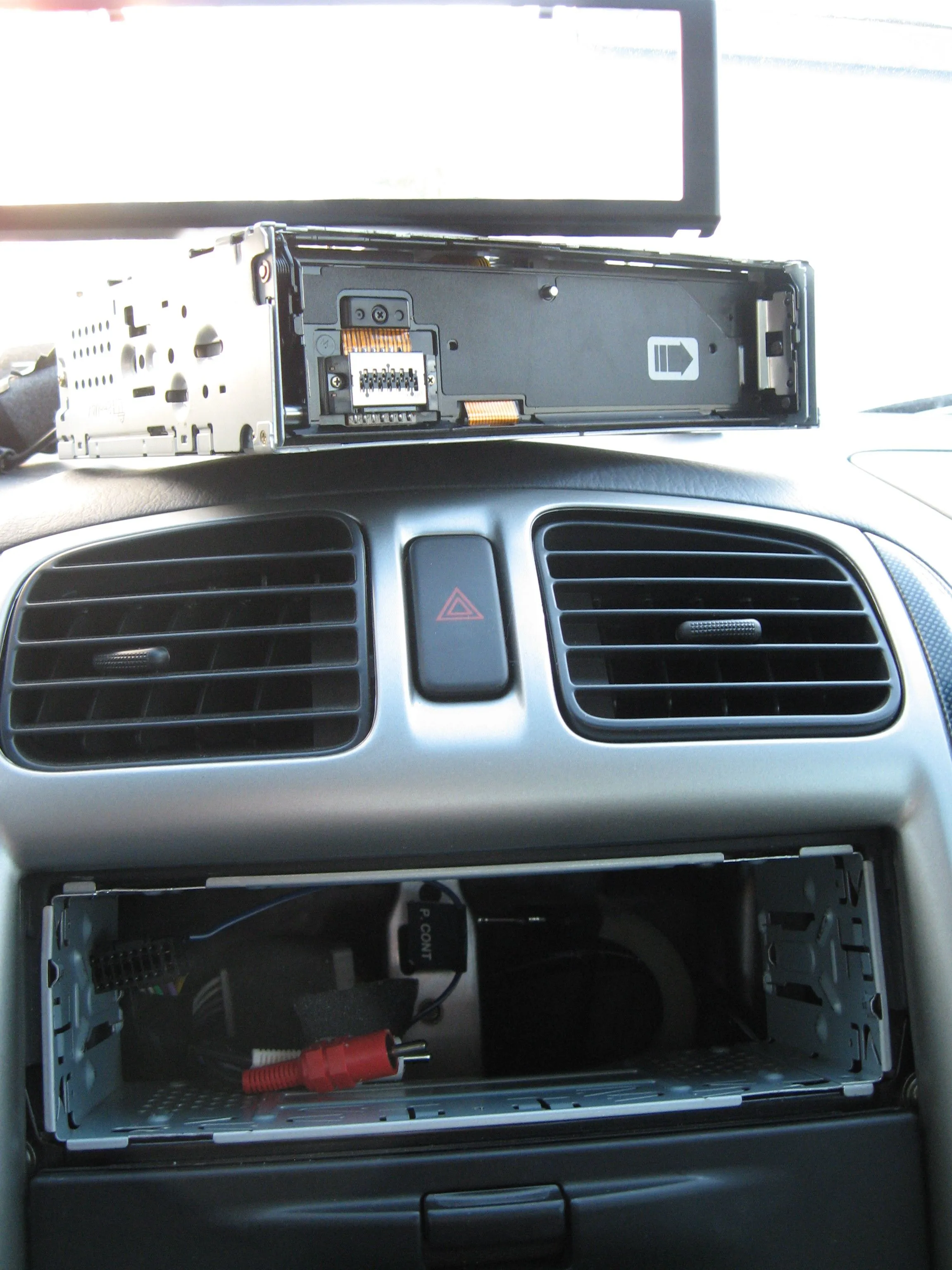

Alright! I've got it figured out!
Thanks for the post Kaldonis! If anybody else is curious, this is how it's done:
1) Leave the trim on (the one with the silver/carbon fibre that goes around the stereo and climate control)
2) Remove faceplate
3) Remove deck faceplate trim. That's the black rectangular trim that goes around the deck face itself. You just pull it off with your fingers.
4) Now you can see the metal frame that surrounds the deck. Slide a butter nice on each side of the deck. Slide them at the same time on the left and right sides of the deck. The knives should be on either side and centered vertically. The help depress a tab that holds the deck in the frame.
5) With the knives in place, slide the deck out. I had to use a pair of needle nosed pliers to grab the deck on the front center.
6) Then all you have to do is disconnect the wires. 1x wire harness, 1x set of pre-out RCA (non-fading to sub), and 1x Radio Antenna.
If anybody else has a hard time with this, like i seemed to, feel free to message me.
