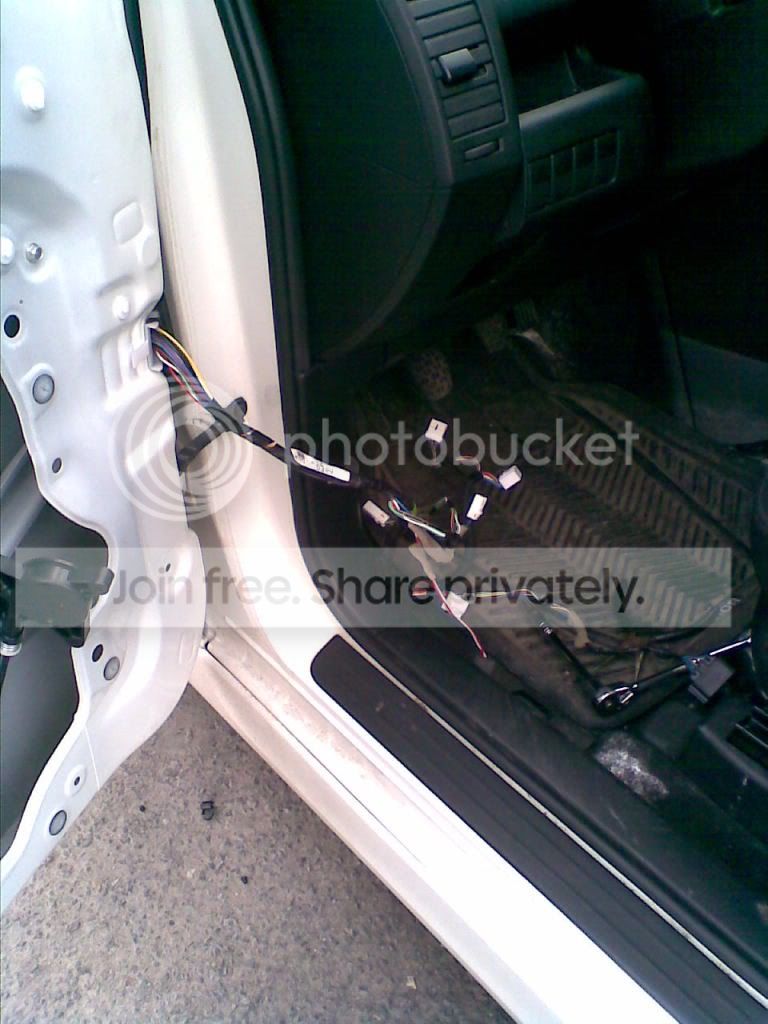

Hi all, i just did this mod last week. Because my english is not as good as my french i would let the pictures speak by themsleves. (cabpatch)
10 minutes later:
20 minutes later:

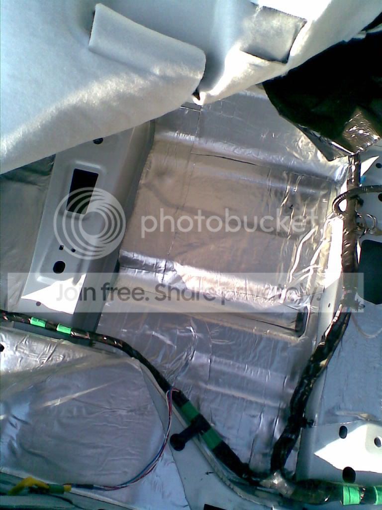

and 30 minutes later: Applying the Resisto.

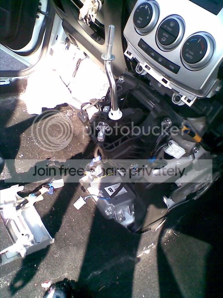

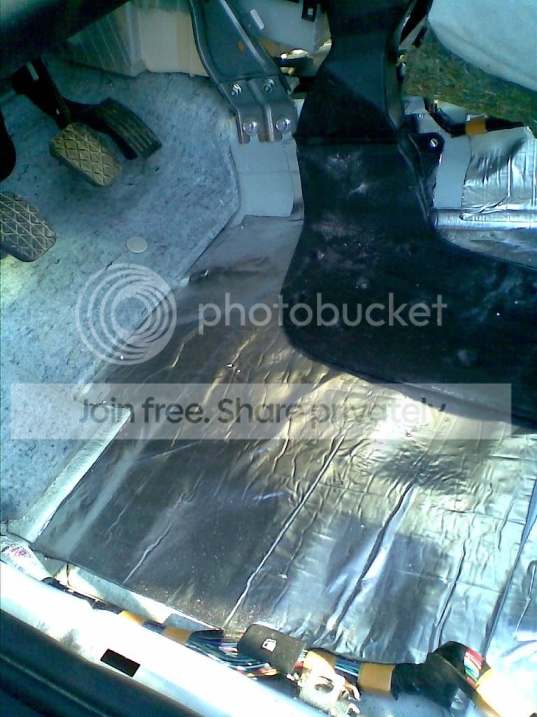

Now the front :

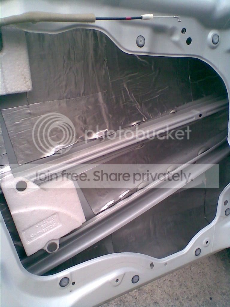

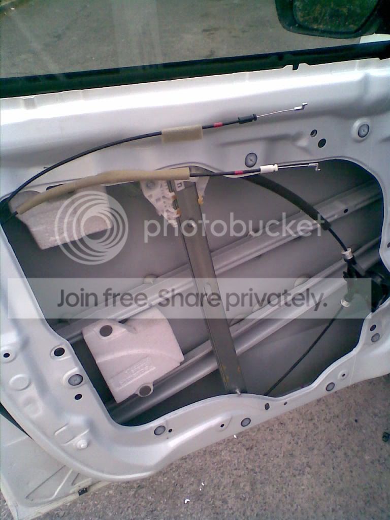

And the front doors:
