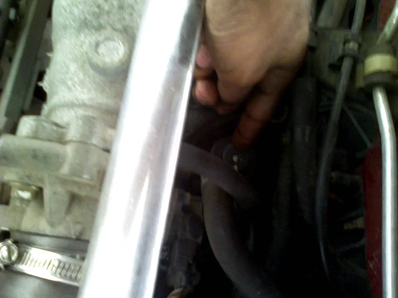

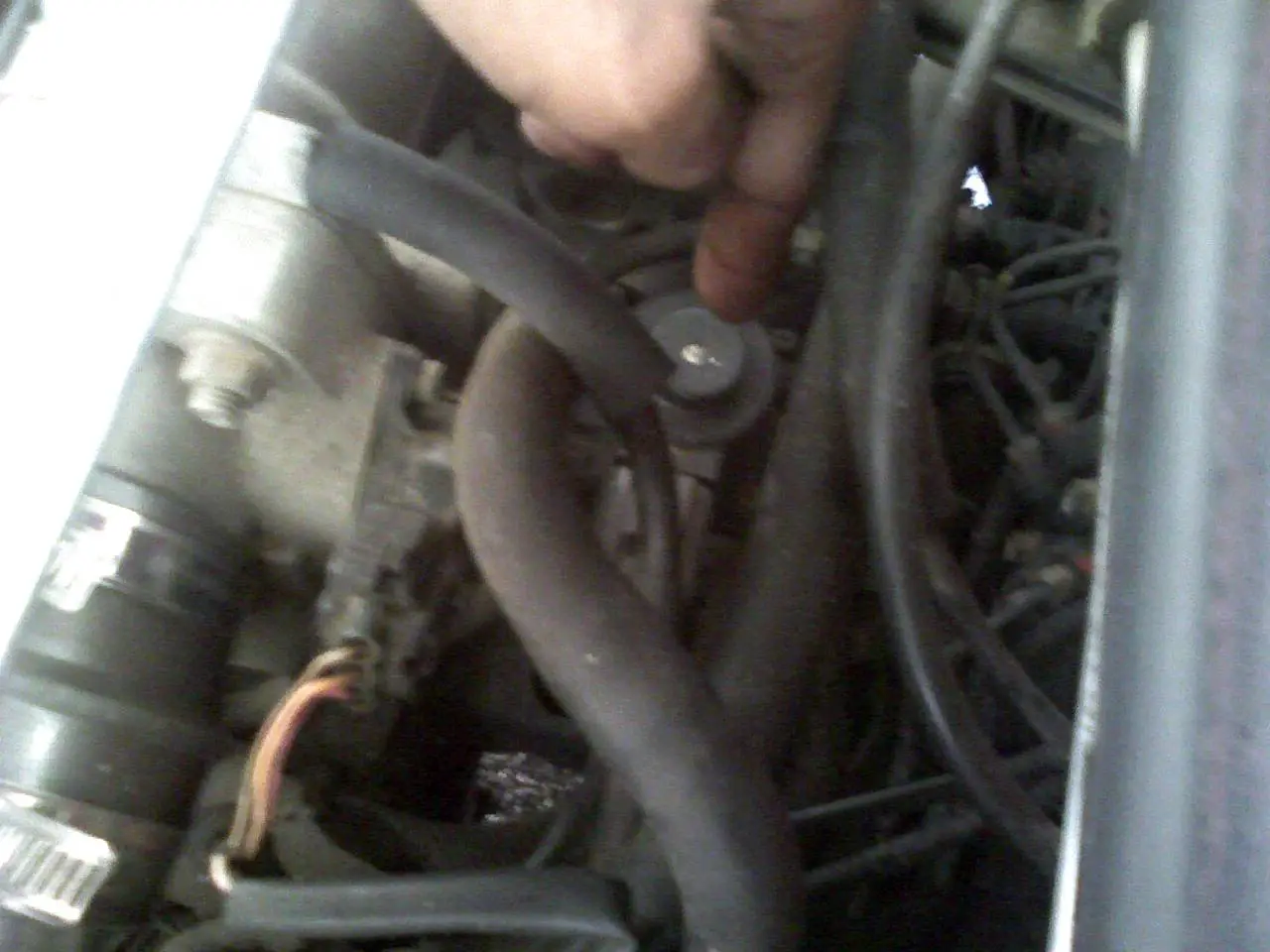

hbk2k1 u probly wont have one. Its directly behind the TB maybe u guys need this(attached pictures). im pointing behind the throttle body, by the ughhh intake manifold and the firewall. thats the top of it my fingers pointing.
Im still wondering if anyone has a smell related to the choking.

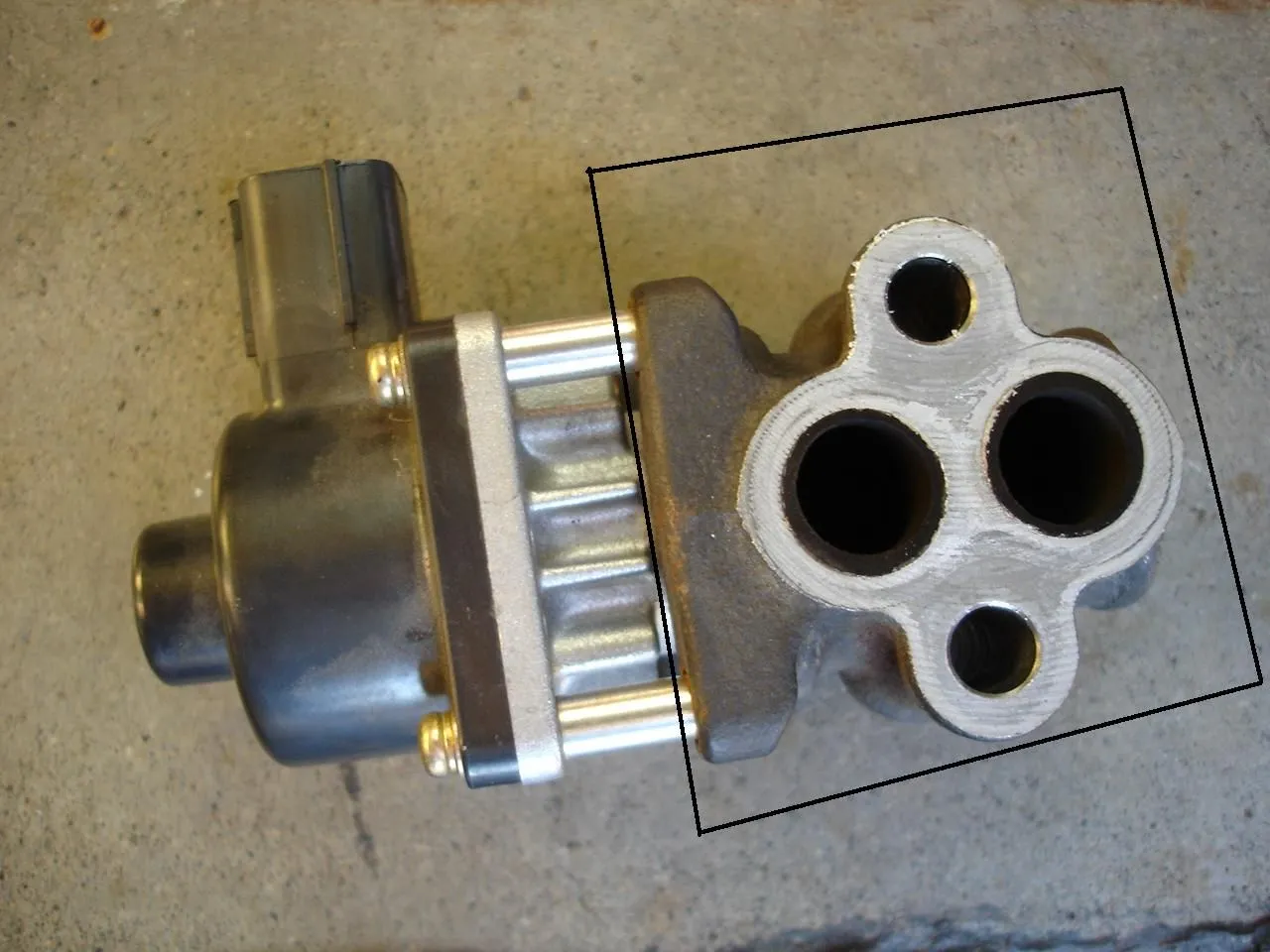

I'll take some photos tomorrow morning, if still needed. You going to need a special torx wrench to take the valve out. Clean the plunger and the housing.
check out the pics. In my case, when i removed the solenoid valve, the plunger got stock to the throttle body. There was carbon build up.

Question: If I can't get those 4 phillips screws out, is it safe to stick part of the EGR valve in a cup of carbon removing stuff?
I mean can i stick the whole boxed in part in a cup of that stuff and leave the top plastic parts out of the solution?
