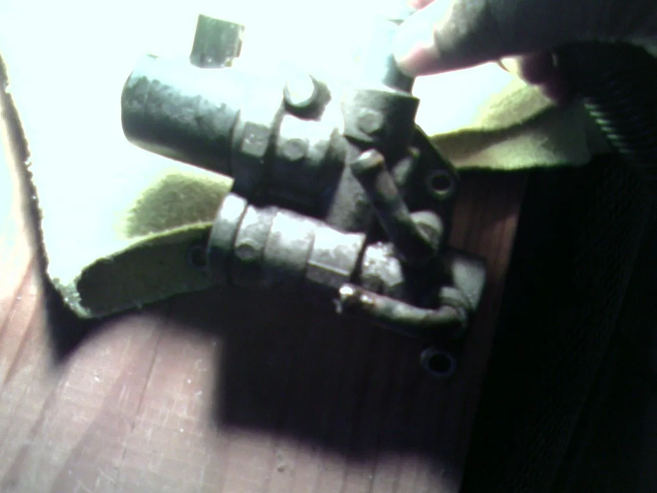

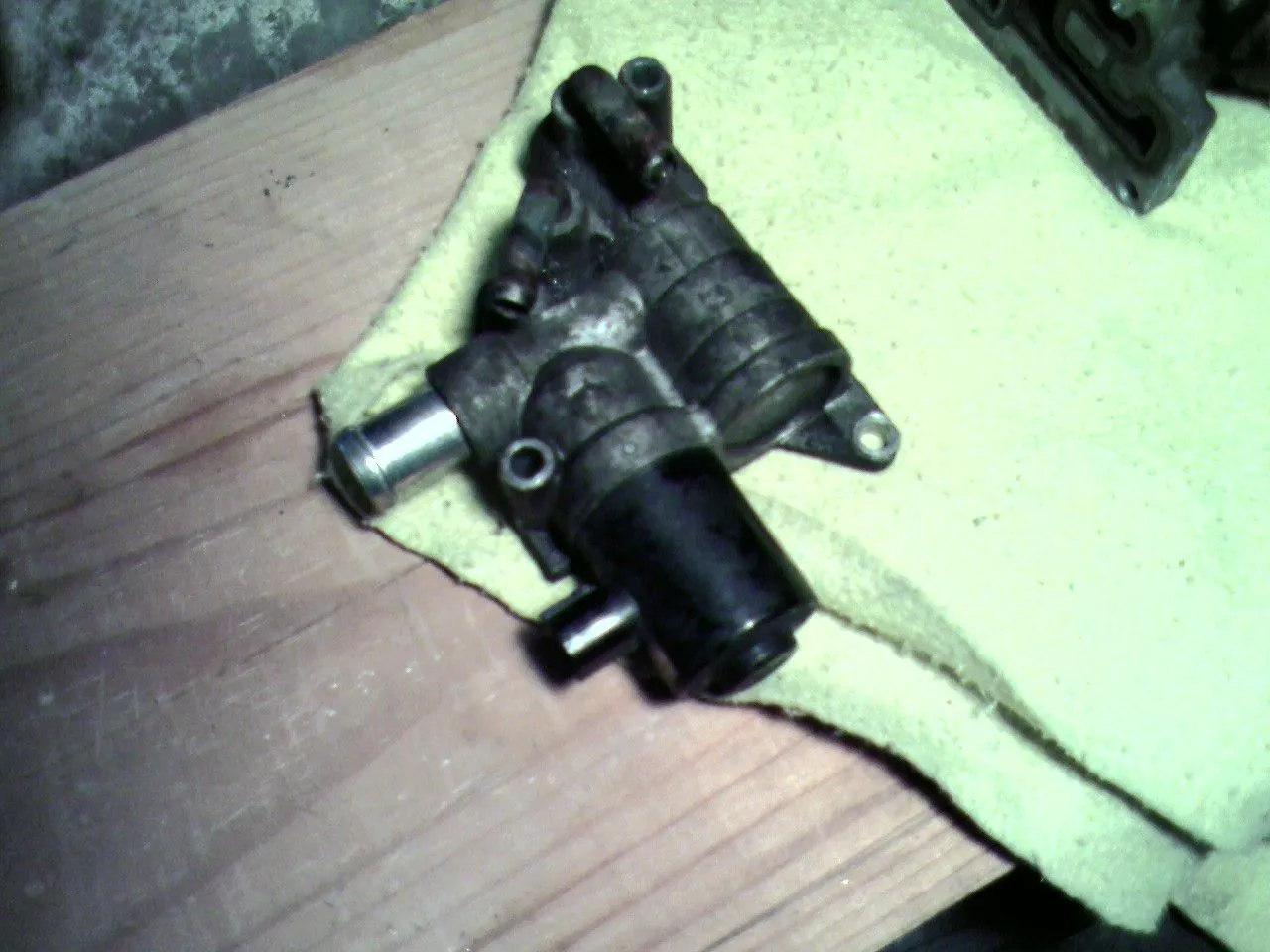

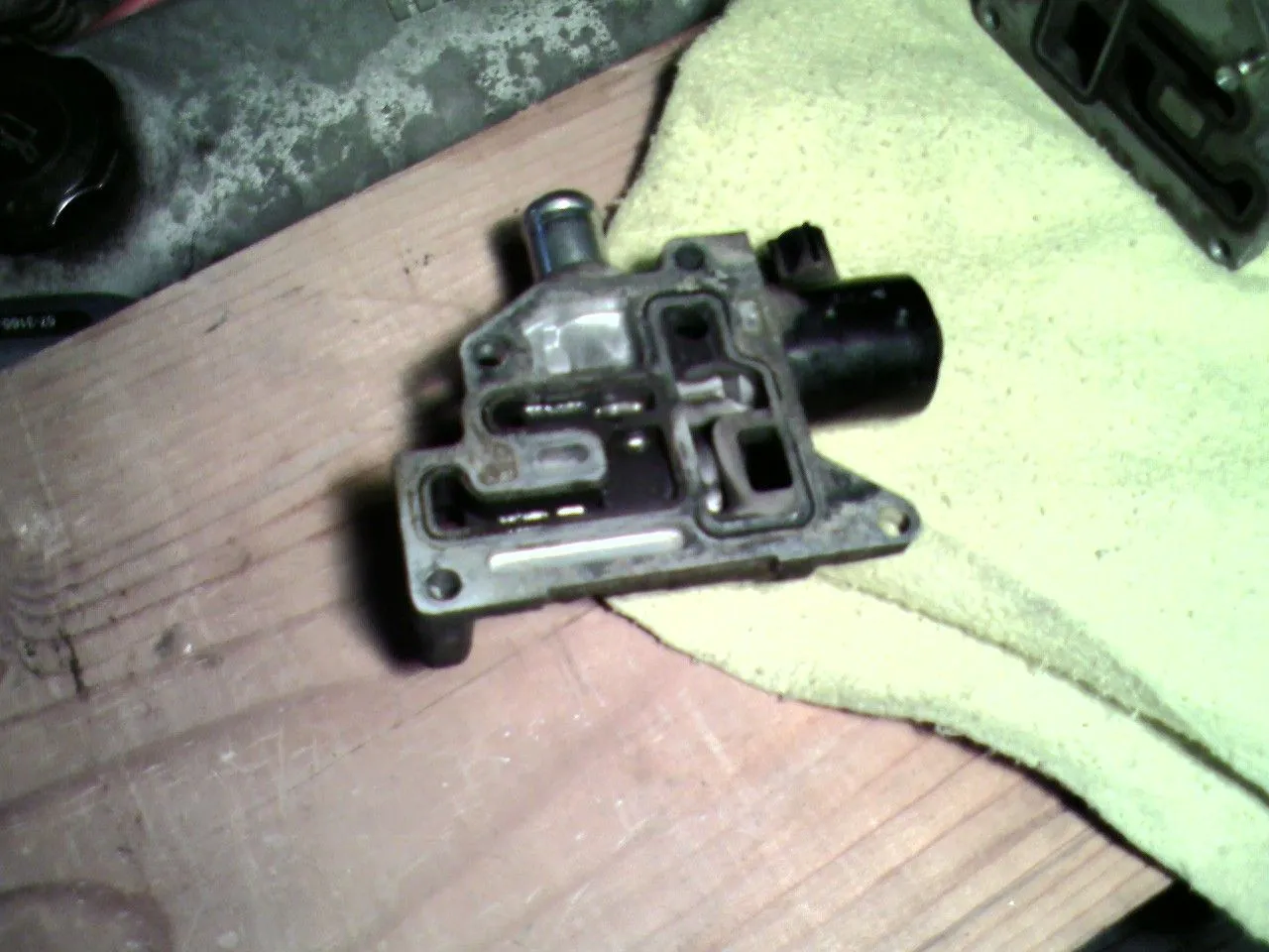

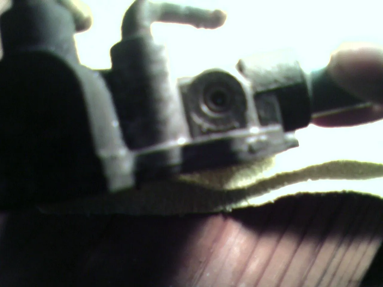

So I have a 95 Protege, 1.8L DOHC LX and have basically followed the instructions on the first page of this thread to get my EGR out and clean it(problem is rough idle and after driving for a awhile and starting and stopping, the RPM would hover around 200-500rpm). I got as far as to get to the darn thing...mind you it was very difficult to get out. Anyway, I got it out, removed the 4 phillips(stripped one of them), and it looked NOTHING like the picture in the first page...so I wasn't sure how the heck I was supposed to clean the inside of it. There was 1 allen key holding the piece together...and I couldn't get it open...looked to be a 3.5 and all I had were sizes 3 and 4. So I sprayed the opening(I could see the spring inside this opening) with some WD40. I put it back together and not sure what else to do...Thoughts?

Here are a few pictures taken today...
this how to is for a 3rd gen pro so the egr is different looking. what you should do is to make sure you can move the piston freely in the valve and work it in for a while and see if it will last you longer then my did when i cleaned it.
I'm relatively new to the EGR discussion......I'm not sure how to move the piston ?
Also, the unit looks different and I'm clueless as to how to go about cleaning the EGR.

you will need to take the the servo off (the part with the plug) to get to the piston and move it. i had to do that on mine.

so does that mean I have to remove the allen key? I can't see any other way of getting the unit apart?
Also, is the unit spring loaded? The last thing I want is to have to open the part and then have parts fly out all over the place and have pieces missing etc...This is a HUGE concern for me.

Am I crazy here, or are these pics of an IAC valve instead of an EGR? if I'm crazy, okay, not a problem. but if it's IAC somebody needs to tell the guy....

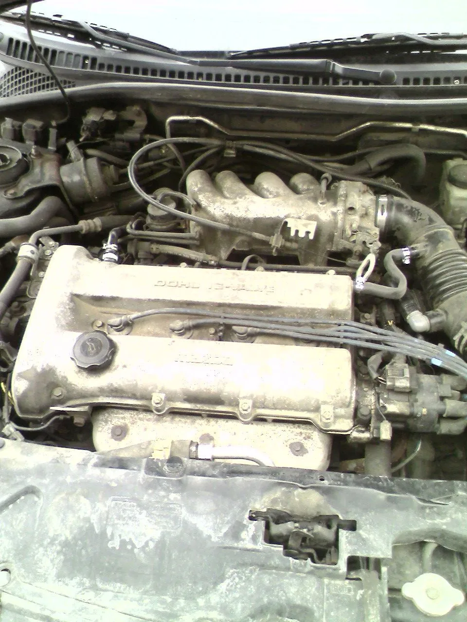

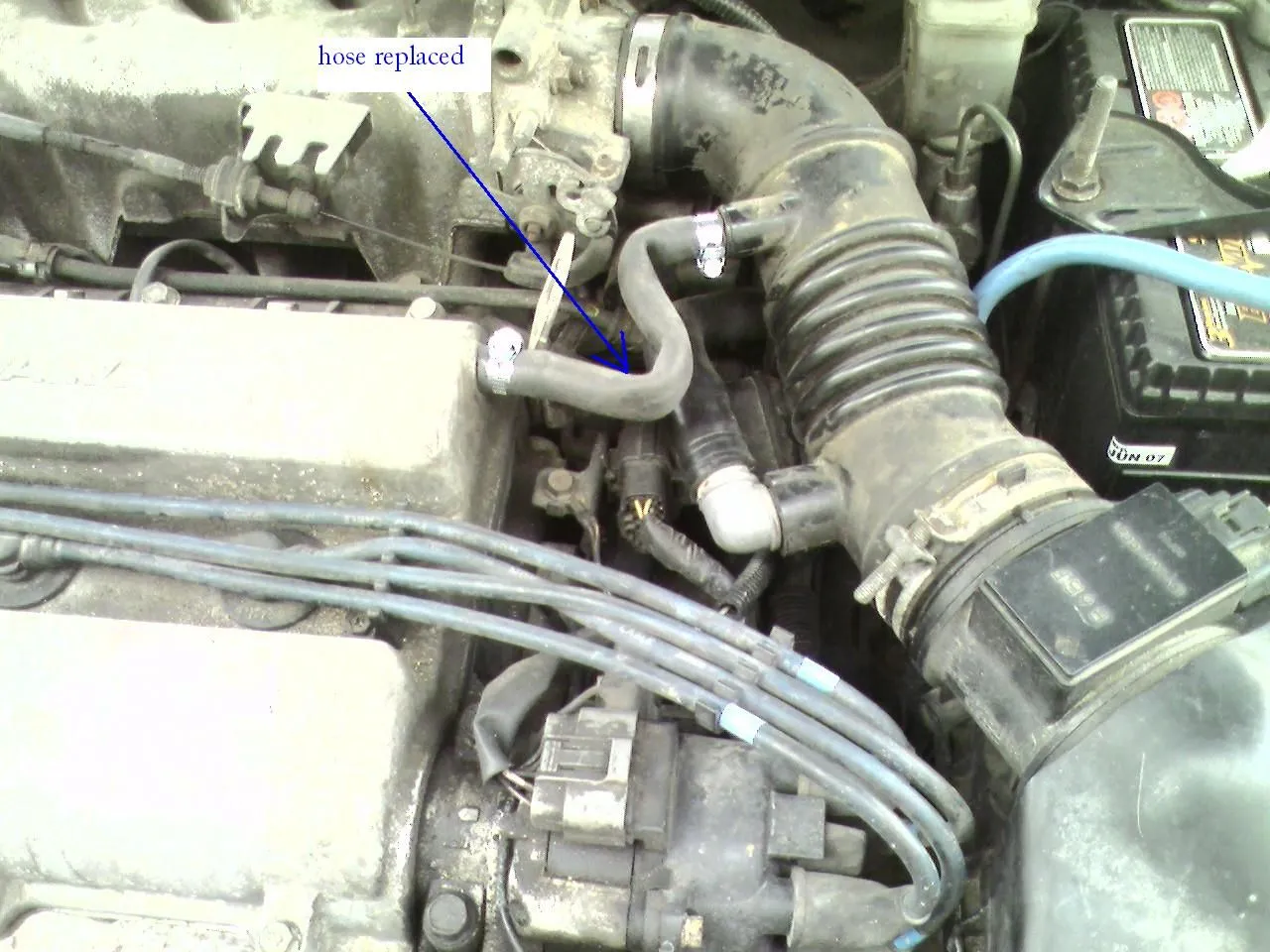

ok......so its possible I may have removed the wrong part.....i feel really stupid about it.......any idea where the EGR is on my car.....?
look at the first page pics. all u should be able to see is the black plug on the end of the unit. the holes u can see in my pic attach directly under the TB (open the butterfly and u can see the holes that the gases pass thru). this is all assuming u have the 2.0.
I have a 1.8L...
here's what my engine looks like.....the only piece i could find that looked like the ones in the start of this thread was the piece in the pics from my previous post...
the car again is: 95 protege, 1.8L LX, DOHC...
