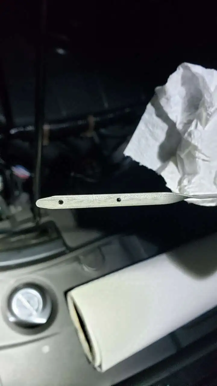

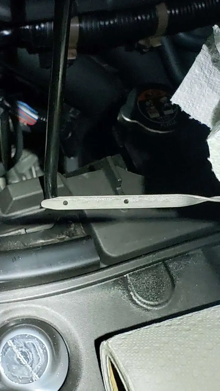

I'm learning how to do oil changes for my 2024 Mazda CX-5. I having issues on whether I put enough oil.
A few days ago, I put my car’s front end on a ramp (so the car was tilted). I drained the oil and replaced the oil filter. Before putting in the new oil filter, I filled it halfway with oil so I put in exactly 4.3 quarts of oil into the engine. (Manual says 4.5 quarts with filter/4.3 without filter). I used a measuring pail to determine the exact amount.
After driving a couple of days, I noticed the oil warning light come on, which scared the heck out of me since I'm thinking I may have accidentally overfilled the engine with oil. When I checked the dipstick, it was really hard to tell if I had too much oil or too little. I just assumed that maybe there was too much because there was oil all the way to the top of the dipstick. No matter how many times I would clean the dipstick, there always seemed to be oil at the top of the dipstick. Just to be safe, I drained all the oil and replaced the oil filter again. (Major pain in the butt but I wanted to be safe.)
I again put in exactly 4.3 quarts. After driving the car off the ramp, I checked the oil level with the dipstick. It’s really hard to tell if I have enough oil or I have too much. The oil is 0W-20 so there seems to be oil all over the place. On one side, there seems to be too much oil. On the other side of the dipstick, there doesn't seem to be any oil. I'm going to wake up early in the morning and check. Hopefully, the oil will have all settled.
Can anyone give me some advice on what I should do?

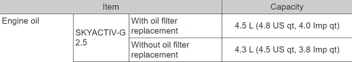

“Manual says 4.5 quarts with filter/4.3 without filter”, this looks like the oil capacity for the 2.0L which is no longer available in the US. What kind of engine do you have? Where are you from?
You can’t trust Mazda manual. When it says 4.8 quarts for the 2.5L NA it really needs 5.2 quarts. 5.1 quarts for the 2.5T but it really needs 5.5 quarts.
Yeah it’s hard to read the oil level on the dipstick. Try checking the oil at the first thing in the morning before the engine start and see. Just pull up you should be able to see the oil level without wiping.

In the morning, the oil was just below the lower dot. Thanks for your words. It was really reassuring just like the other people's here. I was going a little crazy last night. After I wrote my post, I was back outside trying to figure out how to read the dipstick.
It seems like when you turn the engine on, the oil goes everywhere so the dipstick is useless. With the engine off, I would put the dipstick 3/4 in and pull it out in order to clean the dipstick. But no matter how many times I did this, it didn't seem to work.

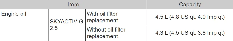

Pull out the physical owner's manual that is in the glove compartment. Look at page 9-8.

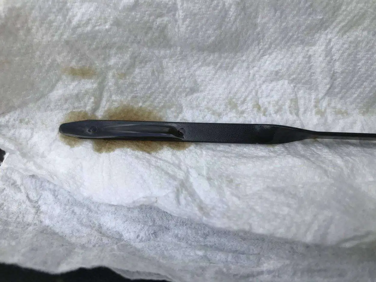

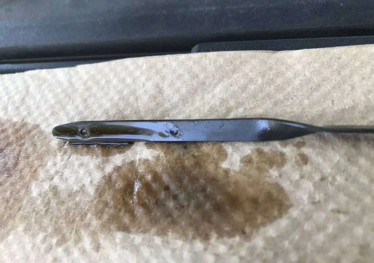

Check oil level the first thing in the morning before the engine start would be much easier to see. In my case I don’t even need a wipe, one pull and the oil level is right there.
Hot:
Cold:
Hot:
Cold:

The problem for me was that there was some oil between and around the markers but there was oil above the markers. It was thick as if oil was there, all the way near the top of the dipstick. That's what confused the hell out of me.
I guess when the engine is on, the oil is distributed all over the engine crankcase. I guess this is a good thing for the engine but it's a bad thing for determining the true oil level.

Thanks. I actually read the section that's above the oil but it doesn't state the amount of oil to use, just the type. You have to go all the way to the end in the specifications section. Why hide it there? ¯\_(ツ)_/¯
