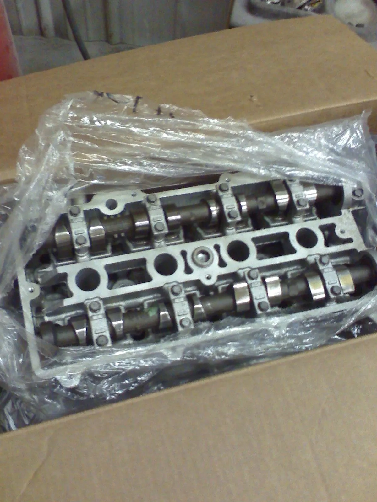

I replaced my seals with the head off the car. I couldnt find a tool that would allow me to compress the spring to get the clip off at the same time. After replacing the seals i still had oil burning so i bought a reman head. I also did rings, water pump, timming belt kit, all new gaskets for everything.

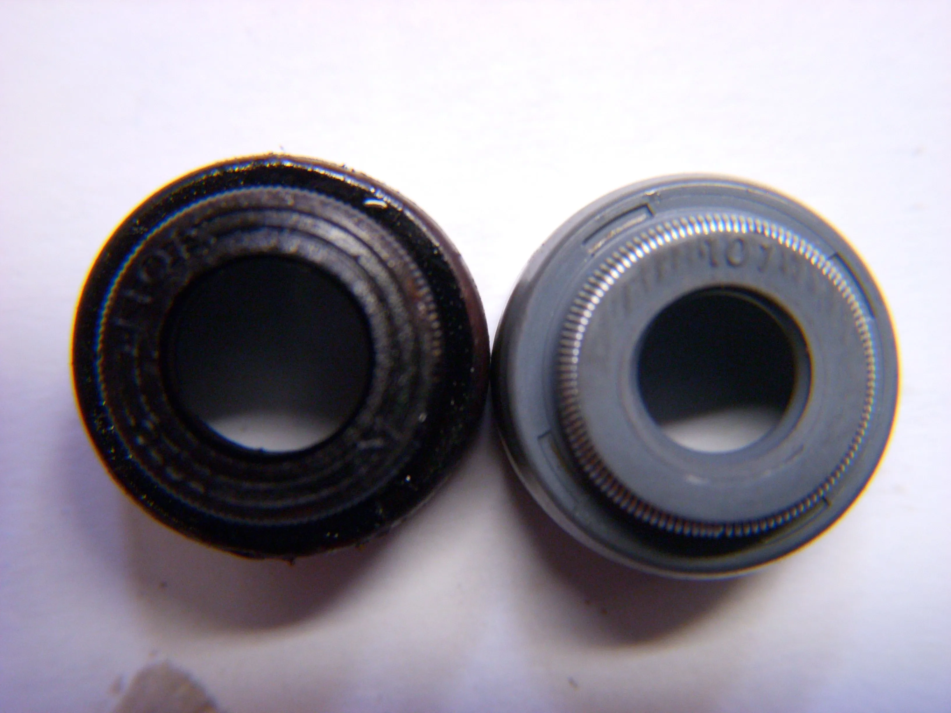

Heres a pic of my seals. The new one is on the right.

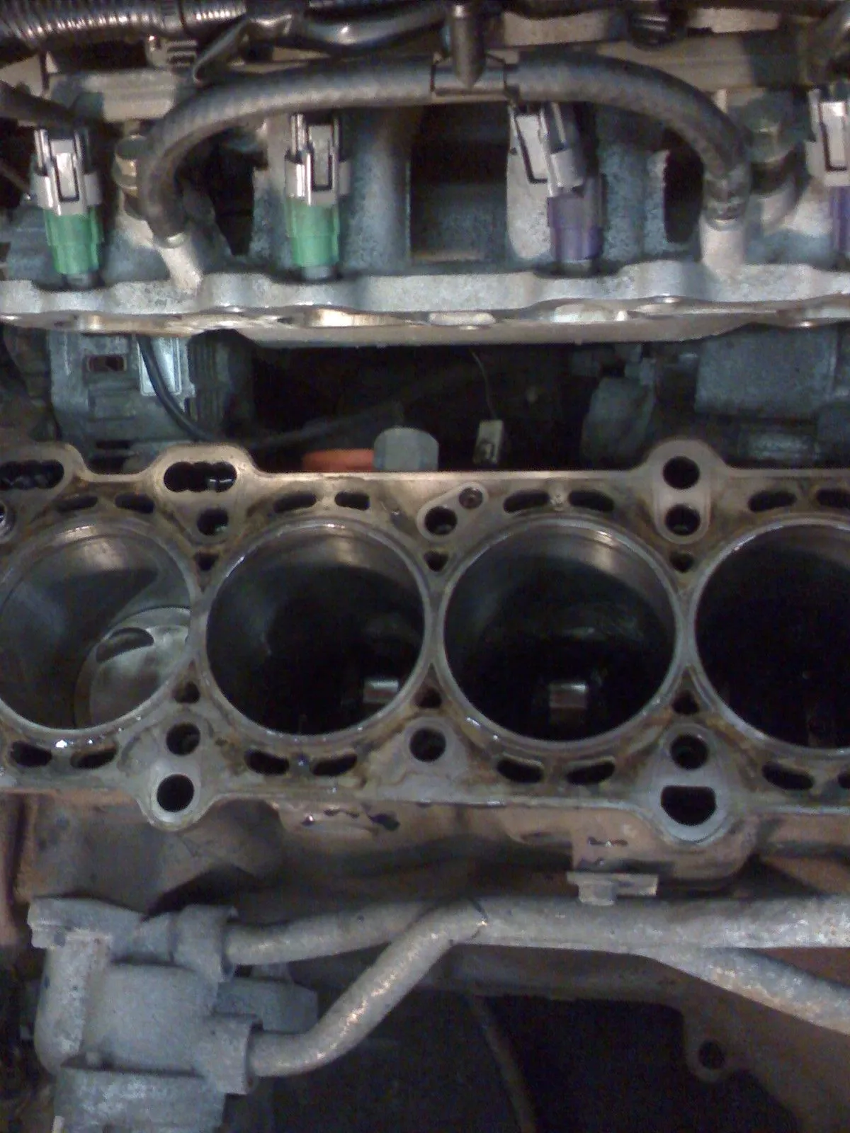

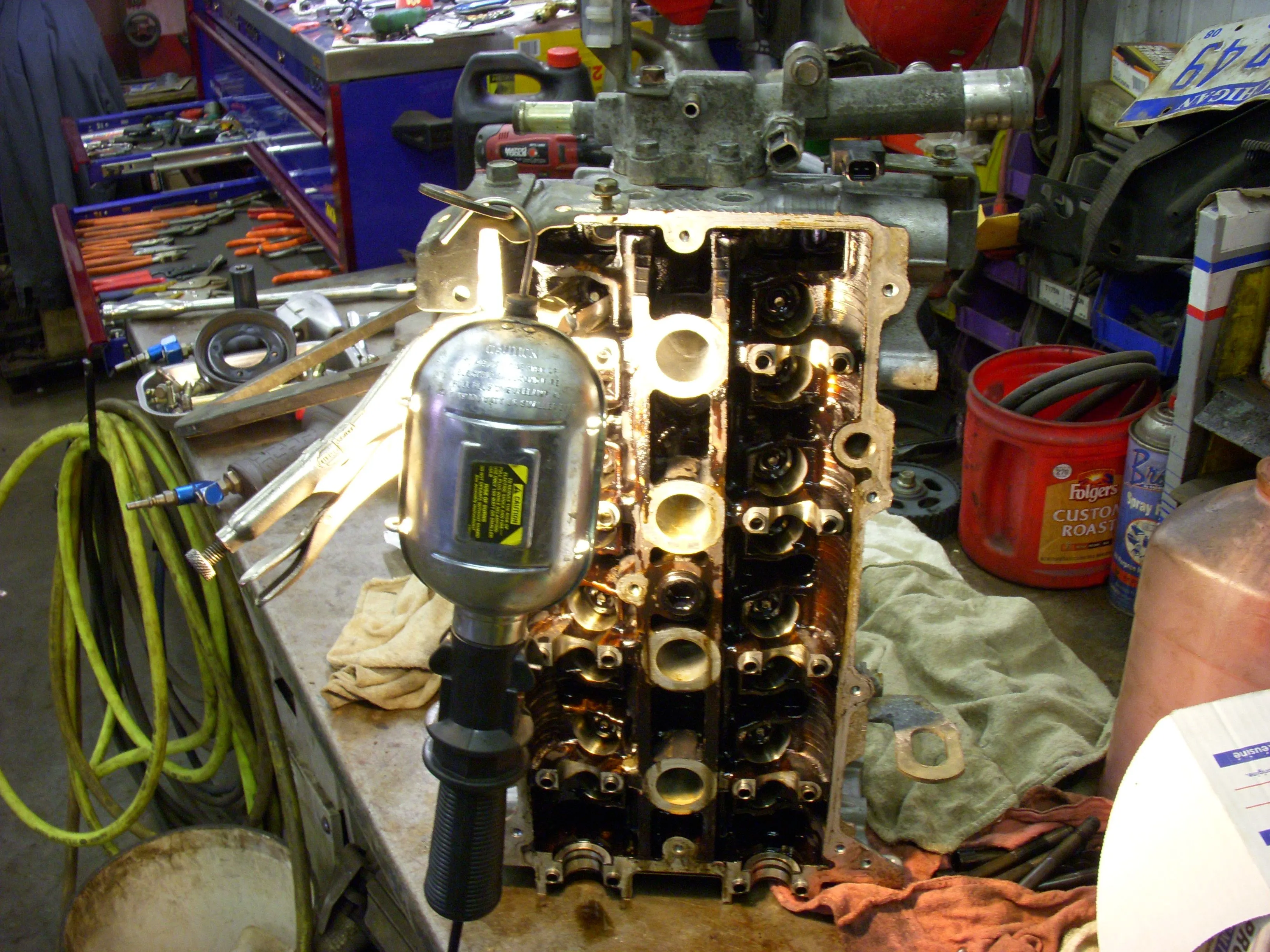

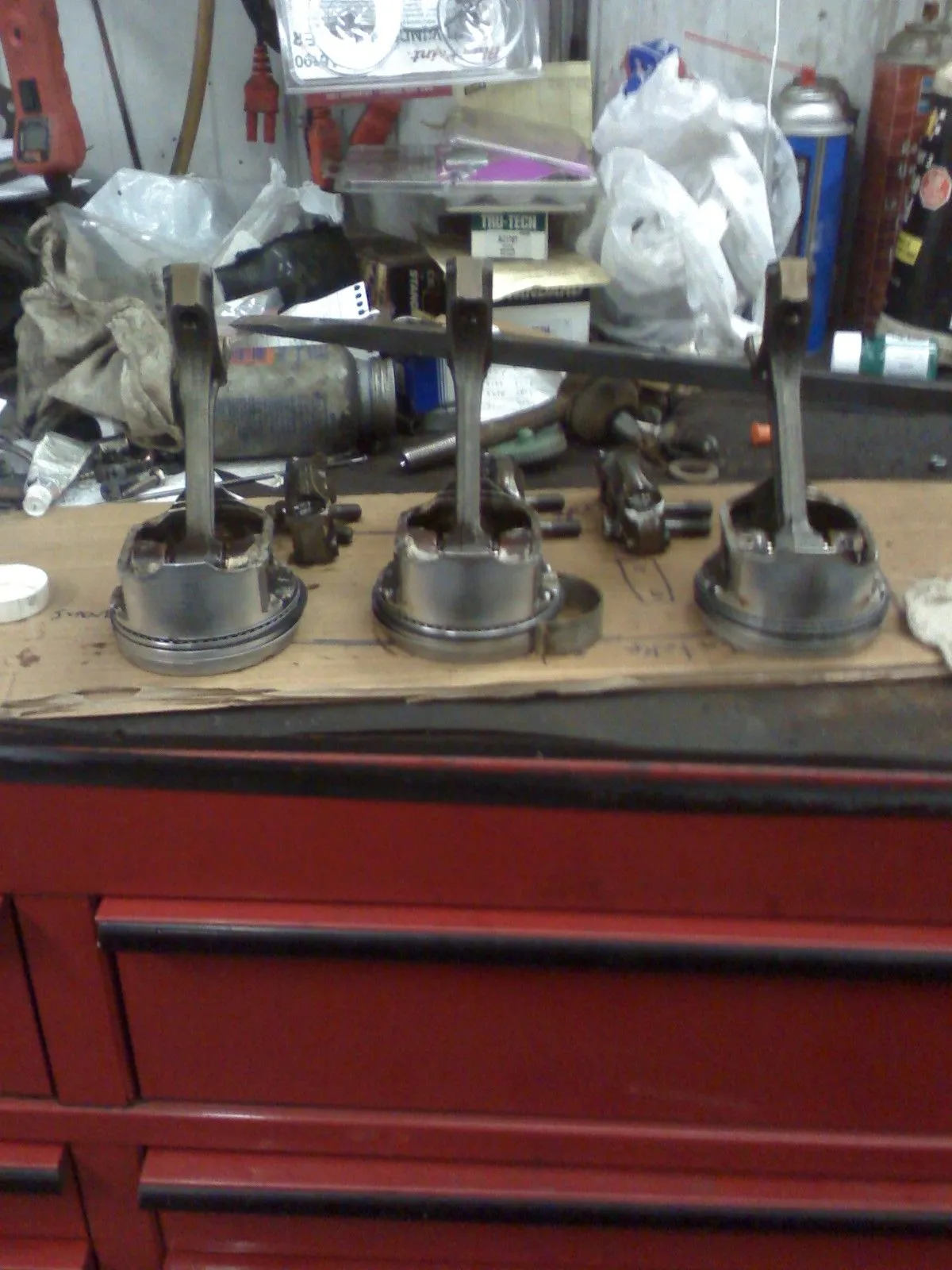

Random pics from the rebuild. I only did the rings because i figured i was that far in i should just make sure the oil rings were good.

Make sure you get the seals from the dealer the sizes are slightly different and a lot of people have problems with the felpro kit
Get the oem seals from the dealer 8 black and 8 green. Intake side is black exhaust side is green

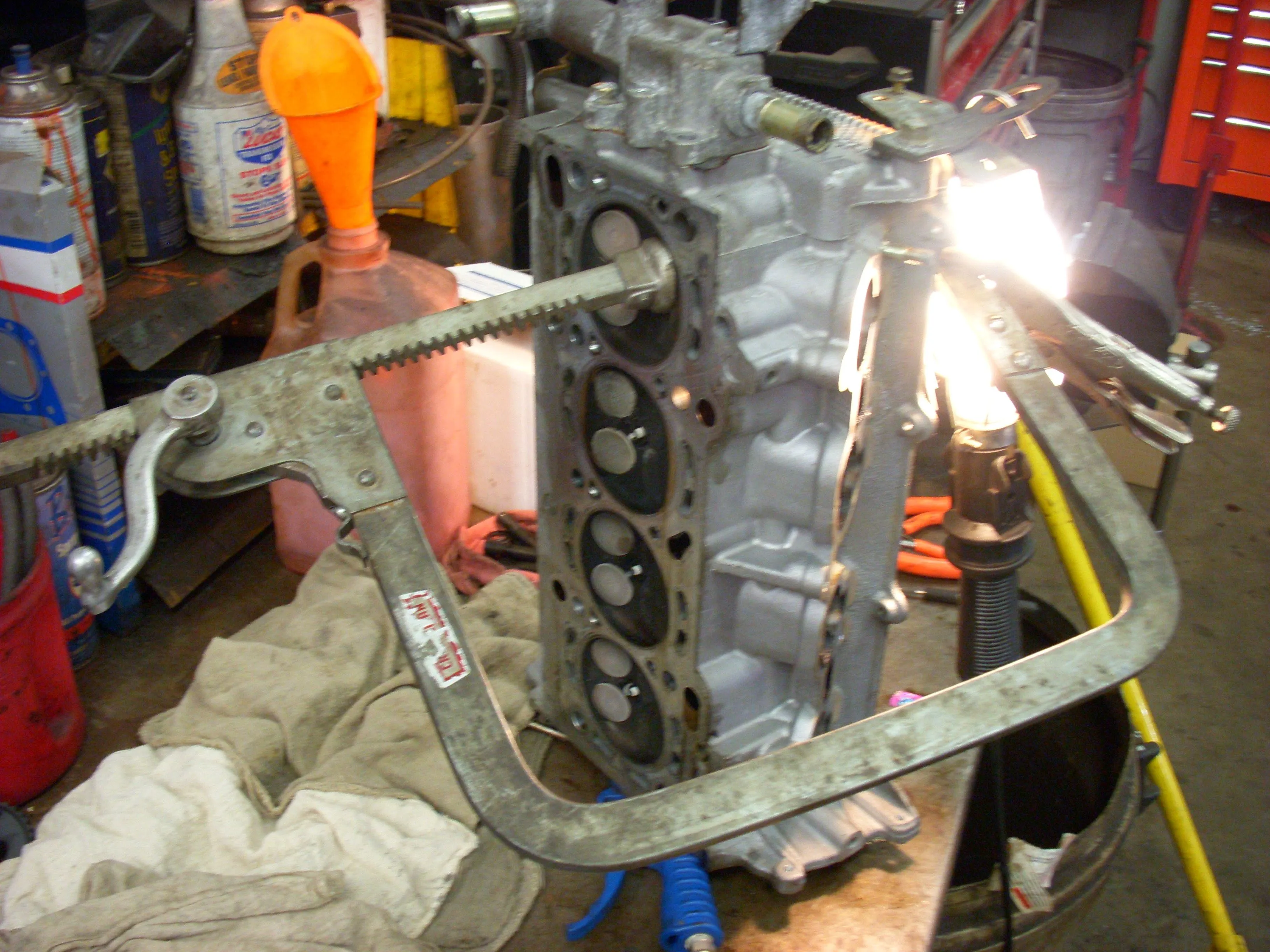

That 36050 tool looks slick. Ill have to look into that. We have valve spring tools at work but they wont fit. Used a head clamp and a socket with a window cut in.
