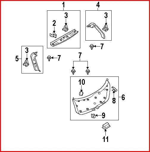

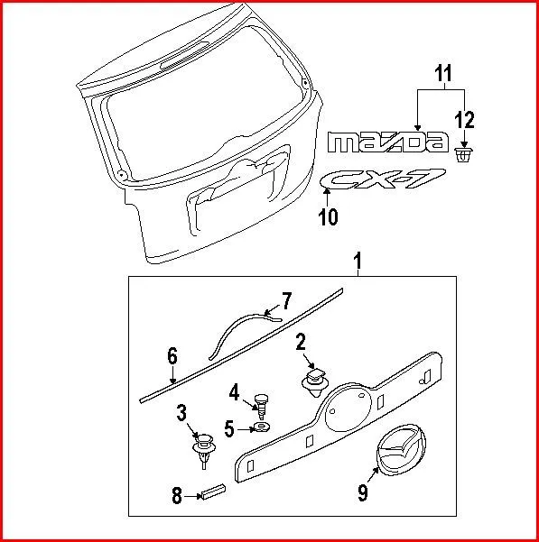

G gosensei Member Dec 21, 2007 #1 My mazda badge on the trunk door is broke off flush with the body. I need to get the inside panel off to access the 3 holes where the broken plastic pins go in to push them out. Does anyone know or have a diagram of how to get the door panel off? Thx.

M MZ CX-7 AB Member : Mazda CX-7 Dec 21, 2007 #2 These are not that detailed, however they may help.(uhm) Attachments mz1.webp 27.2 KB · Views: 481 mz2.webp 14.2 KB · Views: 472
A AlbanianDude Member : CX7 Custom exhaust,cold air, 2 12's double tint all around. Dec 22, 2007 #3 Start by taking the top pieces of the inside and work your way down easyyyyyyy
G gosensei Member Dec 22, 2007 #4 You mean just pry by hand the top of the panel right under the window?
A AlbanianDude Member : CX7 Custom exhaust,cold air, 2 12's double tint all around. Dec 22, 2007 #5 gosensei said: You mean just pry by hand the top of the panel right under the window? Click to expand... Yes pry by hande then you will have a few plastic retainers and just continue on
