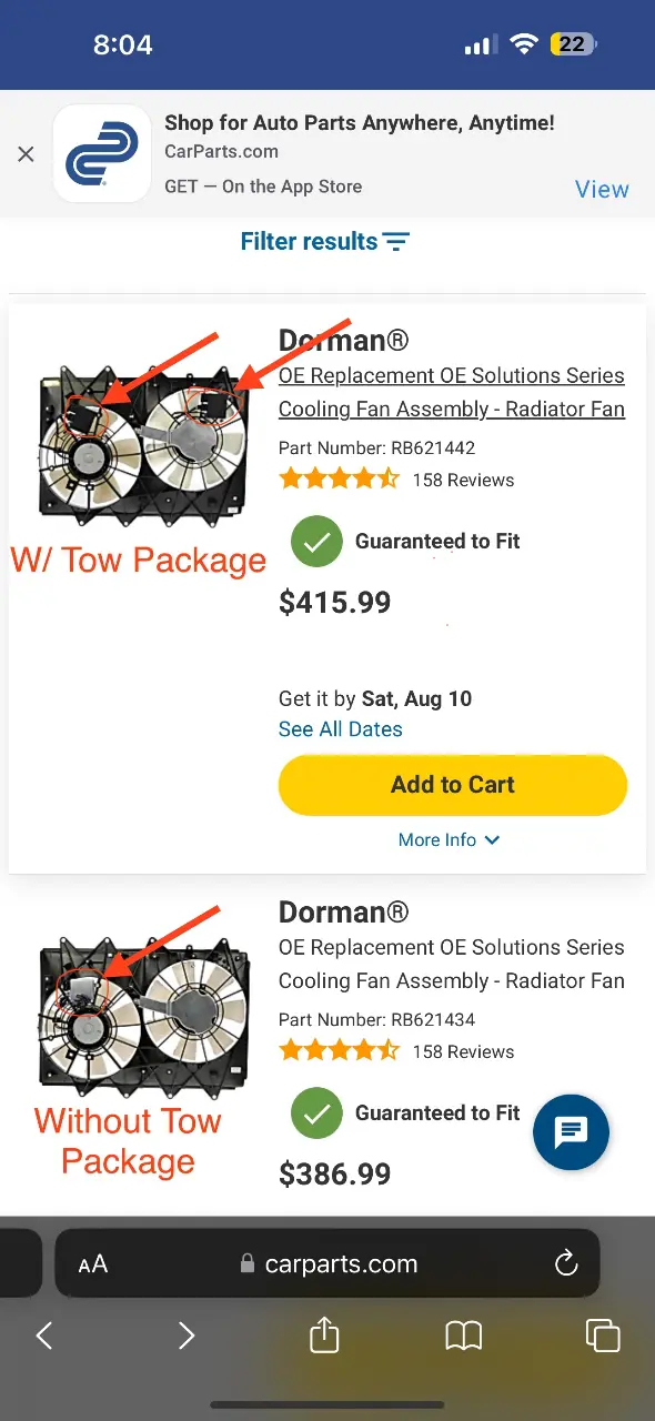

Is this the only thing I’m looking for on my 08 CX-9 to tell whether I have a tow package or not? If I have one fan control module than I don’t have the package but if I have two fan control module than I have the tow package?
