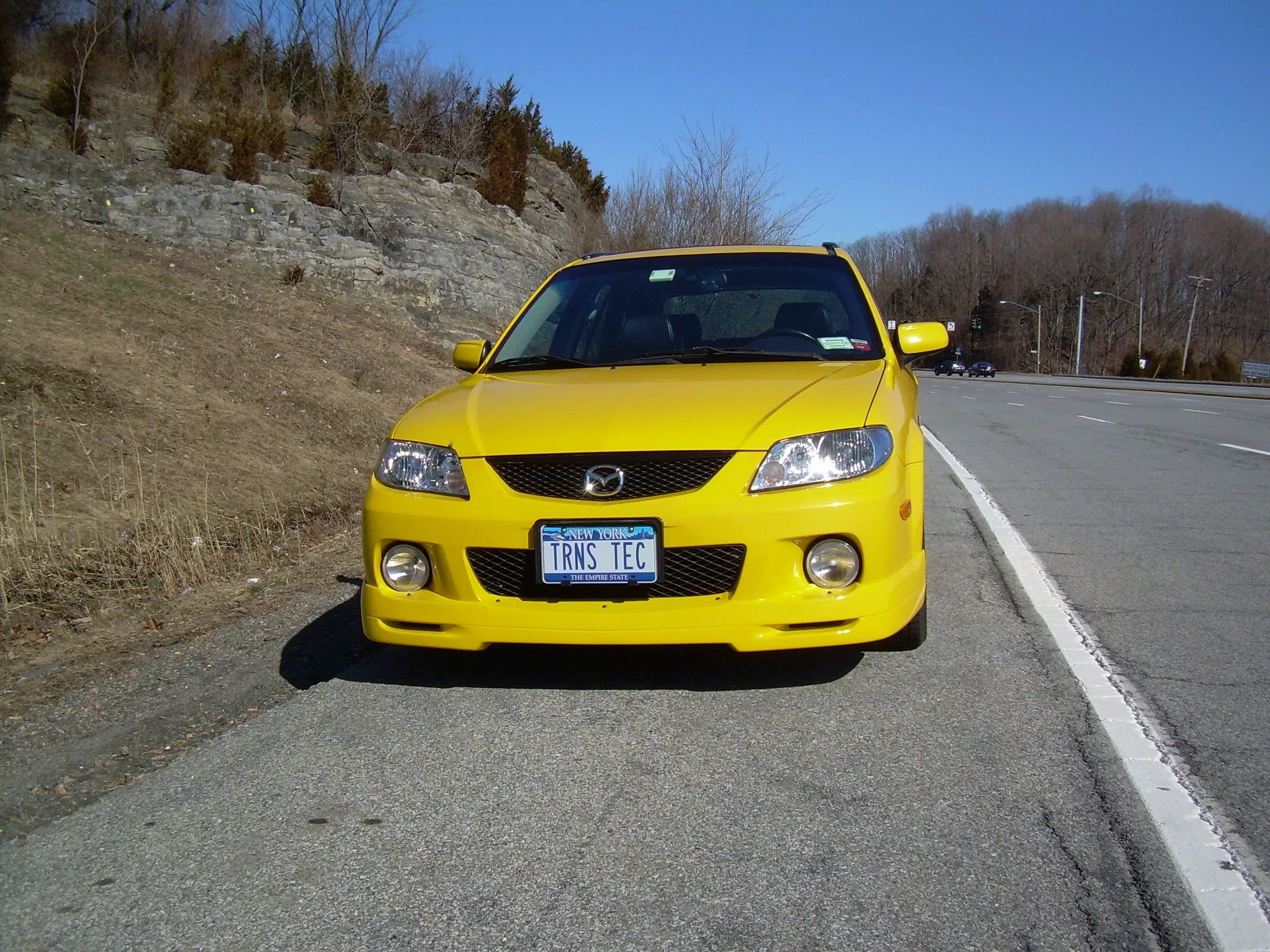

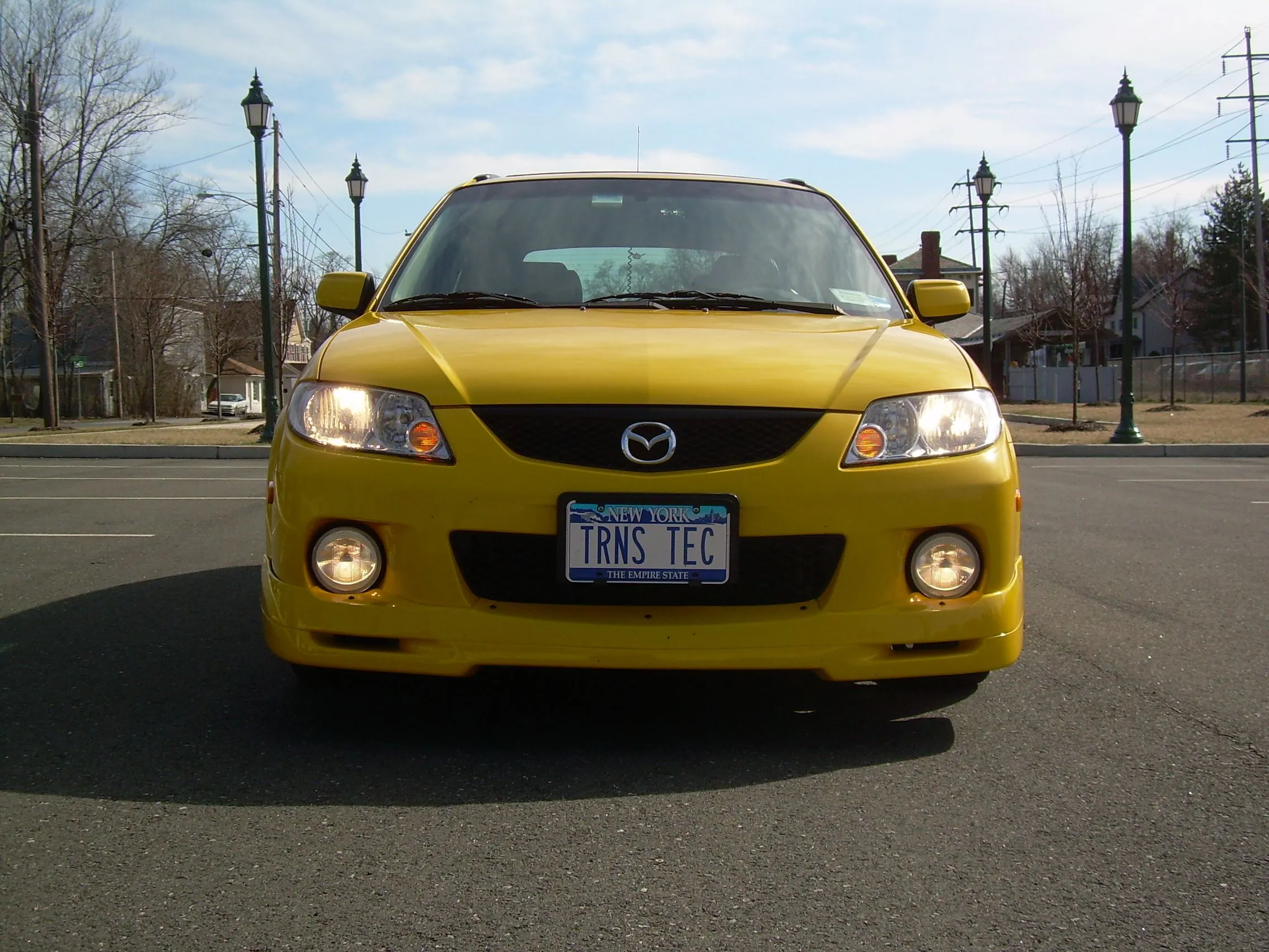

lip spoiler
Would anyone think the extra little lip of the dgm lip spoiler ends up pushing more air out of the way ( creating more drag? ) as opposed to what air would have gotten hung up under the car without the lip being there...
I've been getting easy 30 + on the highway with the lip ( and a fairly recent tune up )... at speeds keeping up with traffic... so I'm thinking that it does not...

I've been getting 30+ as well so I think it may help very slightly if anything. It hasn't hurt anything at all as far as my MPG go.

I think the lip is not hurting anything, but that front plate! (shocked) (poke)
Technically in California we are supposed to have one. Yet I see a large number of cars around without them, and those are cars where it could be just as hideously mounted on the front bumper as in the P5 pictured a post or two above.
I wish the DMV would issue some sort of "sticker" plate which could be molded to the bumper and not be such an air brake.
Hehe, I'm pretty sure I'm supposed to have one here as well.
*looks around*
But it look so sweet without it! Plus, there is extra cooling to the radiator.
