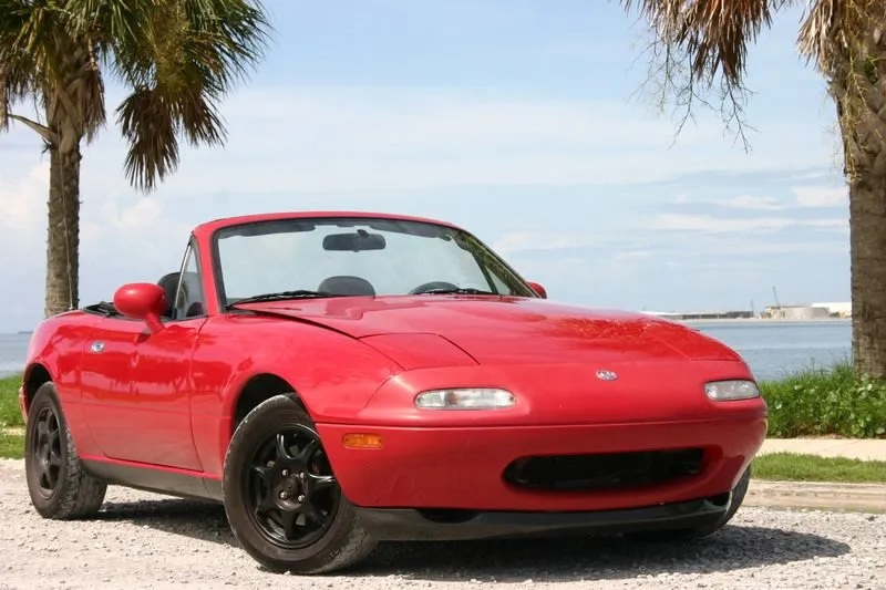

Anyone know if these are just Universal fit type of item? (shrug)
I was curious if anyone had pics of what it might look like on the Pro.
I've been seeing these on a lot of rides and I kinda dig it.
ugggg...looks like the car ws in an accident and poorly repaired. Not my style, but if you like it, go ahead!
Hey,
its big with the 240Z and all the drifters out here. Its kind of wierd though because the bottom of the window is a low pressure area, most guys assume that this mod lets air out the top while it actually does the opposite.
Thats why all the mustang and hot rod guys use a reverse cowl hood
Matt
^^ what he said - at the worst, it will make your radiator less efficient and cause your engine to overheat.
i'm not a big fan of it because to appreciate that, you'd have to know what the mod was. but if you run with a crew of guys who would think that's cool, then go for it.
