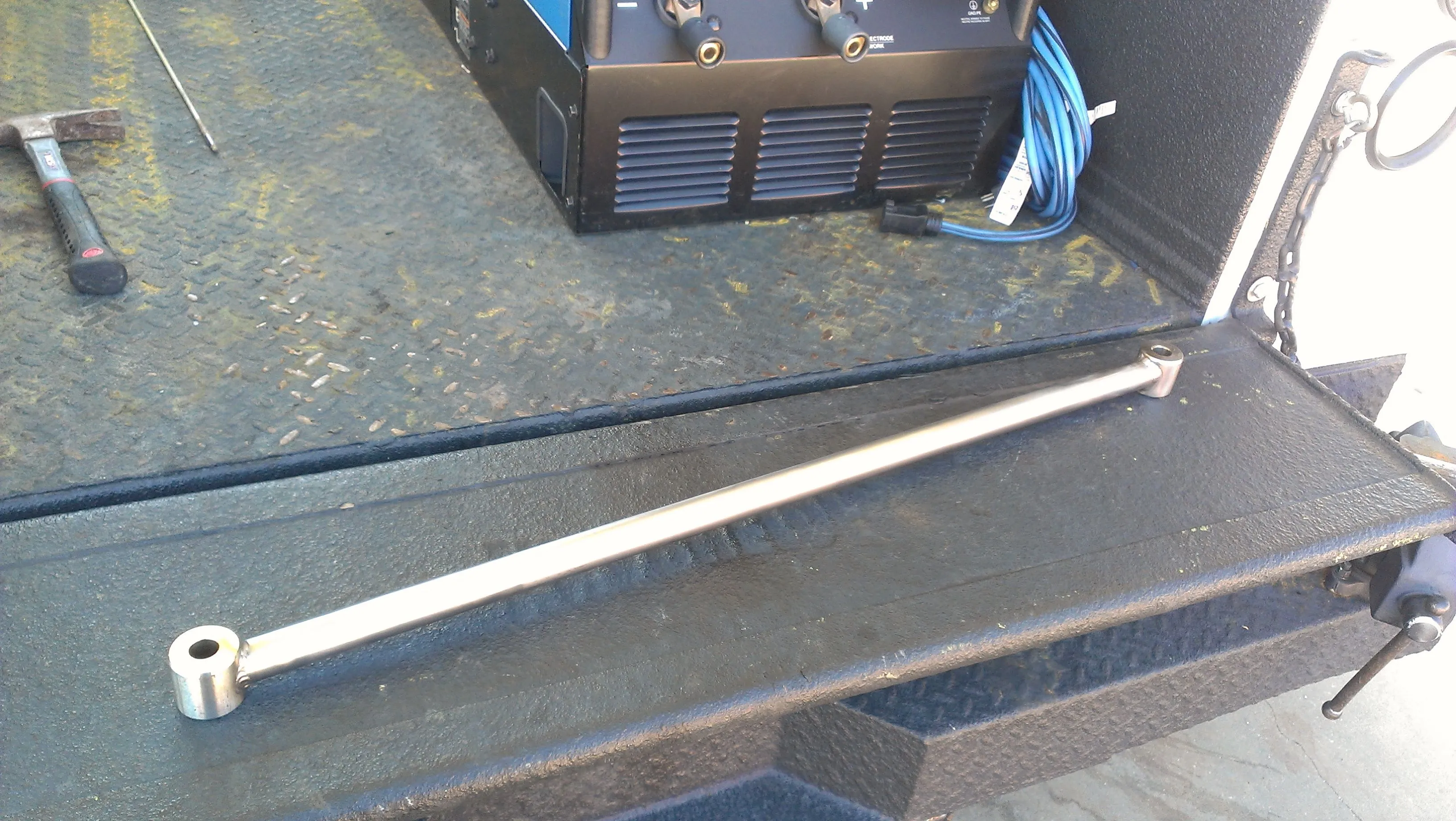

Homemade torsion bar.
Good call. The polished look is nice, but anodized looks nicer. Would you do it yourself? Or send it out?
I have a friend who does stainless jewelery but he may not be able to do this piece because its so large. If it can't be done I will just heat it as hot as I can and burn stain it rainbow like an exhaust. I will know Wednesday.

Rattle can it black. Thats funny, :) that's like painting over a beautiful piece of mahogany.
We just dipped it in this acid bath but had to turn up voltage to highest setting because its so dense.

ok point takin ..your proud of your work and want to show it off..im same way when i do mods to my harley..ive done anodizing at home personally i dont like the finish of anodized parts ..im into powder coating now..done quite a few parts for other bikes etc..PC isnt any harder than ano but finish is way more durable ..i coated a derby cover when finished i hit it with a hammer and it didnt chip just dented with the aluminium..worth checking out if ya havnt already..i got my system from columbia coatings its one of the best systems for the money out there ..
I agree 100 percent, but stainless steel is a beautiful finish already and there is no reason to coat it. I already have a ton of things car parts, tools, wheels,and equipment powder coated. By the way anodize job came out horrible so I'm just going to polish it and burn stain it.
Re-polished after the anodize dibacle. Next up burn stain.

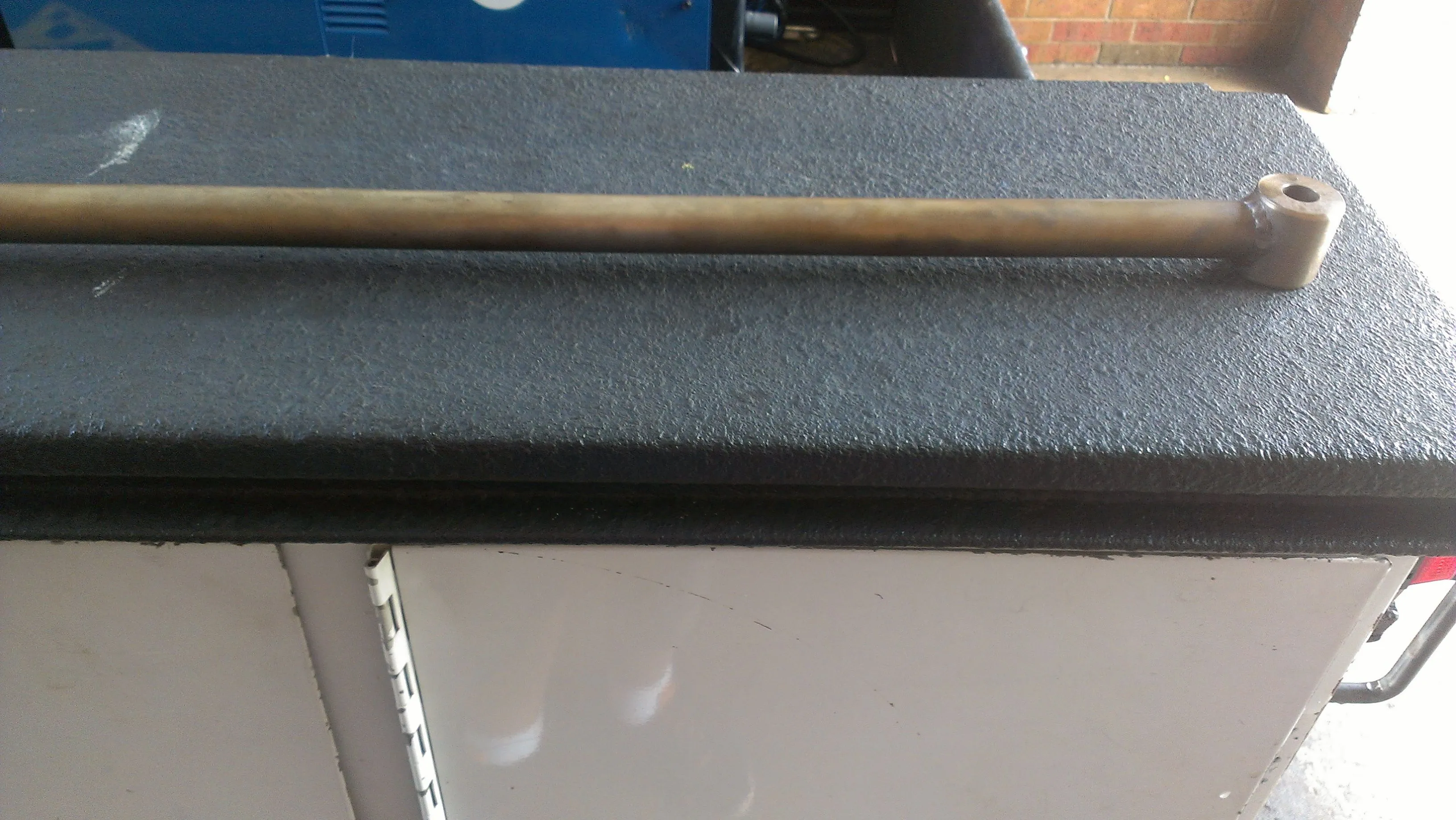

So far its gold but I need time to get it hotter and then buff.

Been driving with my bar for a while now and just installed some plastic washers inbetween mounting hardware. I was getting a tiny squeak in hard turns and all is well now. Also torqued fasteners to 85 ft lbs.
