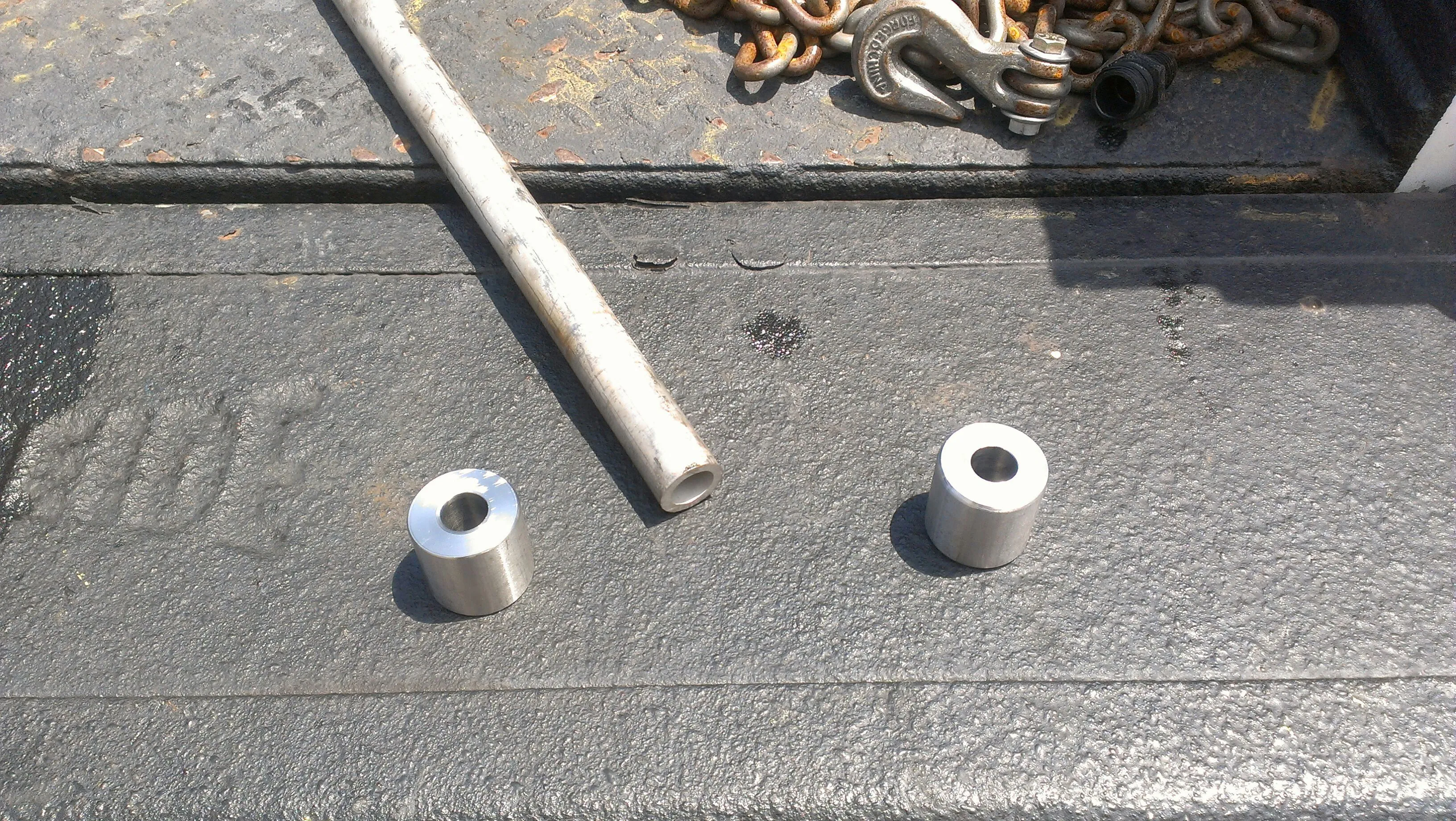

So we don't have any 1.5" tubing.... Only 1"... And scrap pieces of other sizes, so I am using 1 1/4" tubing on the outer ends, and 1" tubing in the center.... We'll see how it goes I guess...
Just cut my pieces 2x 1 1/2" shaft cut 1 1/2 tall 1" tube sched. 80 for cross piece all 301 stainless. Drilling takes for ever and I'm impatient colbalt bit with drill press water fed after this machining sides. I have at ig ill be using to weld together.

No problem I'm lazy this weekend working on it tomorrow. Milled my end pieces and drilled my holes.
Coming up next welding......

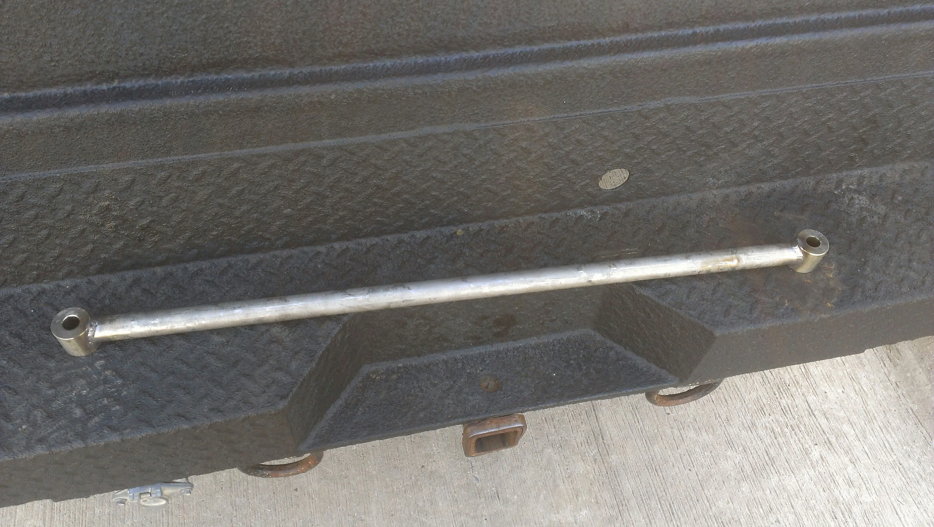

I just installed my bar. The dimensions are correct, I messed up before I welded the bar, and it was too long. But 820mm is the correct bolt center dimension.
I have pics of the finished product, but none of it installed... I was excited to test it. And it works beautifully. I think it works better than the last bar I made. I have no idea whether it is because of the new mounting locations, or the change in materials though. I'll try and get some pictures up tomorrow.
When you make a bar, if anything just do it like I did. I mounted the ends on the car and cut the tube to fit. I then just put a few welds to hold it together then took it off to fully weld it. No need for accurate dimensions then.
That would've been the easier route if I had all the tools I needed at home, but I built this at work, and I didn't want to bring any jack stands to get underneath the car. Plus I would run a strong likelihood of puncturing a tire if I were to try and get the car into the shop.
Fits great so far going to clean it up and get 1/4 inch longer stainless fasteners and washers.
