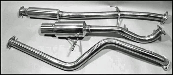

I took my car to have my emission done a few months back, and the guy that inspected my car said I have a hole in my flex pipe? I have a Corksport exhaust and its stainless steel. (Please see below)
But the flex pipe and forward is all factory. Any idea on where I can get a replacement flex pipe? Preferably stainless steel?

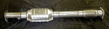

Maybe somthing like SLS is selling but without the converter? (2nd Photo)

give this guys a call they do custom exhaust setup. I had them install a new high flow cat about 6 months ago on my midpipe and they did a great job. I also know they have flex pipes that can probably weld into your midpipe.
http://www.bandtmotorsports.com/
Thanks for the link, how much did something like that run you?

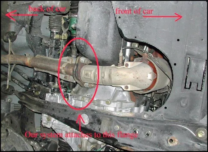

Based on the pic of the Corksport exhaust, I'm not sure if the one you mentioned without the converter would fit? The flex pipe comes off the end of the 1st pipe in the 1st pic i posted? Here's another pic from CorkSports website, its installed on a MSP so there is no flex pipe. But u can get an idea where the flex pipe "should" be on a 3rd gen based on the pic. (Right in the area where the red circle is)
I would just talk to CS. They use a weird pipe diameter (like 61 mm or something) and the flage location is not the same as stock. You wouldn't be able to say, buy a PG midpipe and use the CS catback. I mean, if it broke from routine use it could be a warranty issue. Even so, they'll probably tell you where you can get another flex pipe.
Ok, so i talked to CS. It was still under warranty so they mailed me a new midpipe. The new midpipe they sent me doesn't have the flex portion, so i'll be running all piping. IanBMurray came by the other night and tried to help with the project, but the bolts were rusted. So i went to Midas today, they installed it for like $90 and all seems to be well at the moment.
