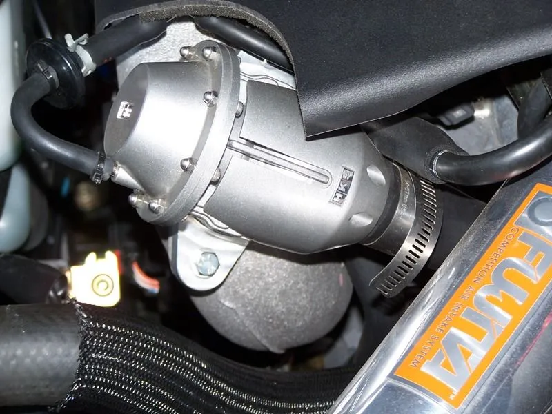

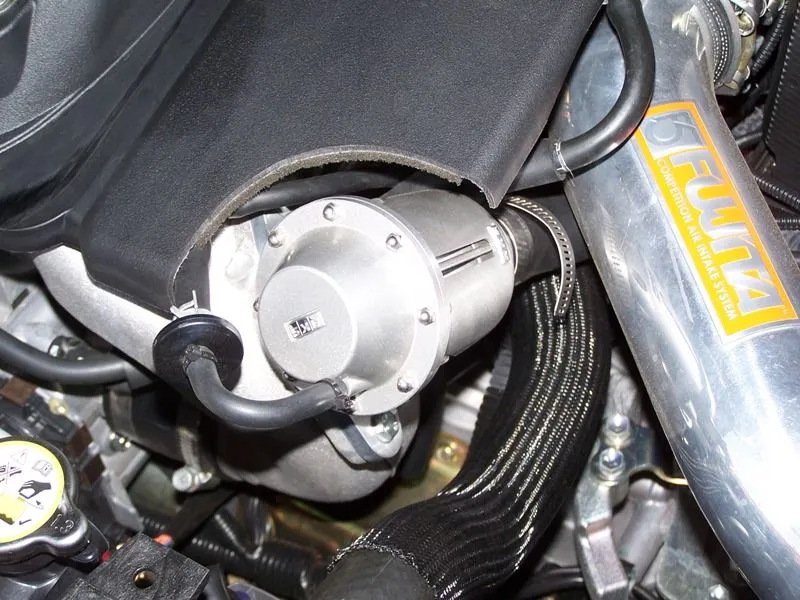

Not sure what you are talking about I will take a pic of mine and show you.
Here this is what I'm talking about and hopefully I understand what you are saying. Your talking about that little hose in the front that used to be on top? As you can see I reclocked it so it would be on bottom.

HOLY SH*T i never thought of that hahaha. thanks gonna do it tonight. i bent the line down so far and it seems to hold up. hopefully i can bend it back without any problems and go from there. well then solves the problem. thanks

yeah i thought you meant you turned the bov 180*, and then i inferred that you were venting, either way though, i bent the line down and it's doing the job perfect. if i have a problem ill just re-clock the rear. anything special on how to do it besides take out the screws?
I've found you can also adjust the hood bumpers on both sides higher and that will stop the ducting from rubbing too harshly on the line. I think I am going to get rid of the HKS and go with the Forge BPV since it's a little more stealthy and not such a PITA (snap rings and all)
