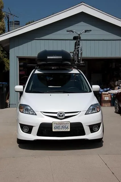

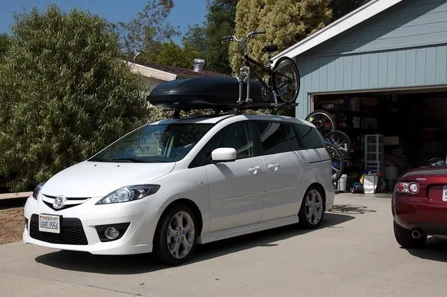

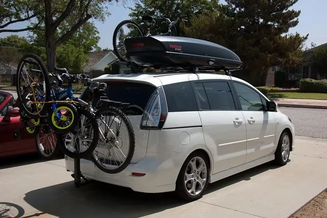

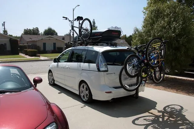

Here are the pics of the M5 loaded up to the gills.
And no shot is complete without at least a glimpse of Pepper - my 06 MX-5.
The rear was sagging a little.

To my surprise, the car handled fine. I was quite conservative with my driving, but was still pleased. Also, MPG only dropped 1.5 mpg or so, which isn't too bad.
Wobbling
The way this type of hitch attaches is gonna allow for some wobble. The give that it has on the M5 is nothing compared to some other cars. I saw a mini Cooper that had 2 bikes on it. When the car turned, you could see not only the sway of the rack but the twisting torque. The 5 does pretty good, all things considered, for a class I hitch.(whistle)
