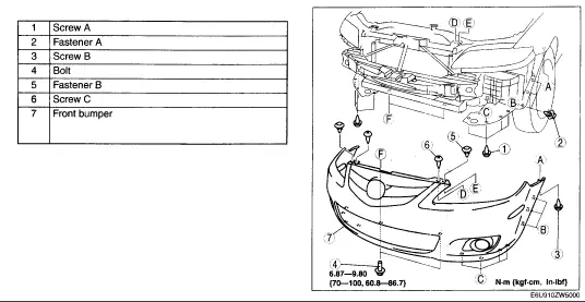

Pull the bumper and then pull the headlamp assemblies out, swap bulbs, then reverse. I've heard getting to the bulbs is a bit tricky. I don't know of a how-to for removing the bumper though.
Taking a bumper off isn't terribly hard though, just put it up on ramps/stands, then find every bolt, screw, or fastener touching the bumper and then try to remove it.

Hope this helps, follow the order on the table, 1= step 1 etc...
I installed my passenger headlight without taking out the bumper from the top, but the driver side is a PITA to get to without taking out the headlight assemblies.

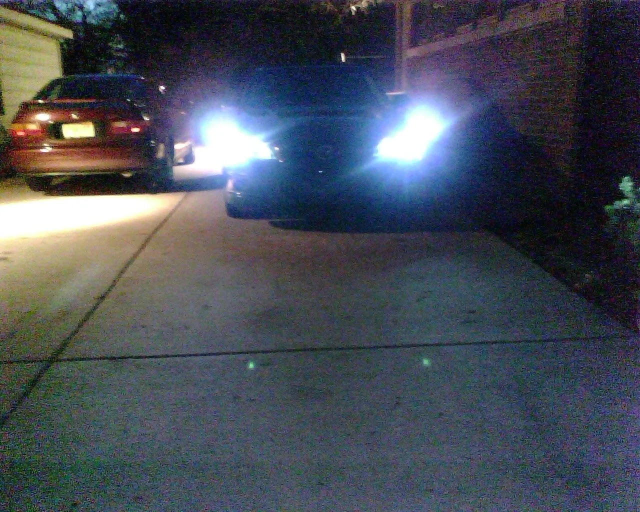

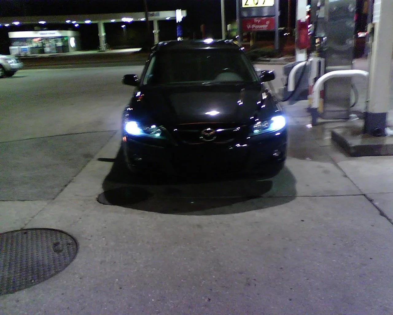

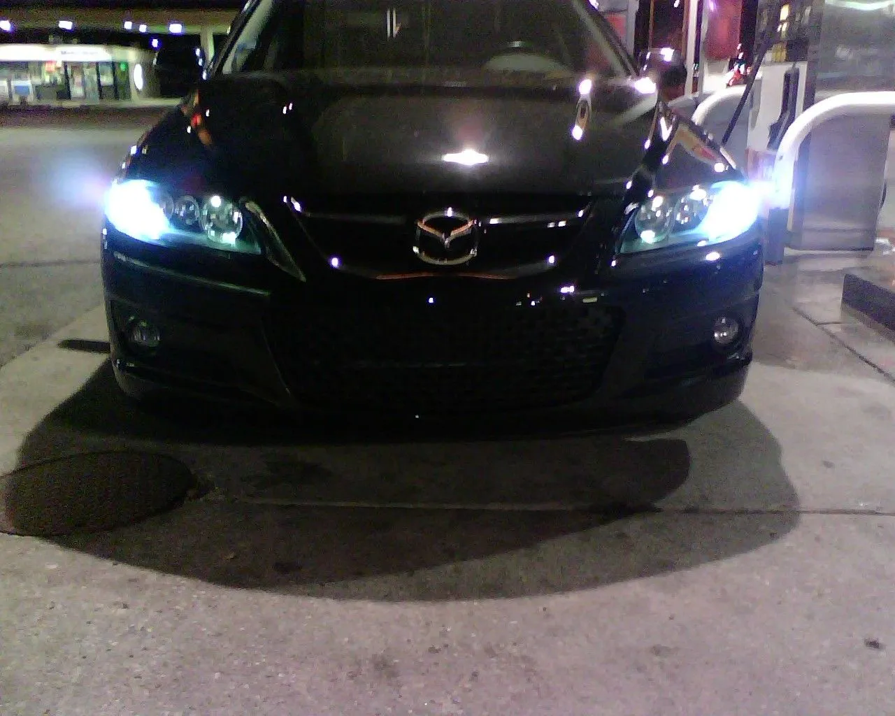

so here are some pics that i managed to get in my spare time... now i understand that they arent the greatest pics since they were taken with my fone but i will post more tomorrow night with an actual camera lol.. i was just busy today with school and work and had no time.(stooges)
better quality pics coming tomorrow night
