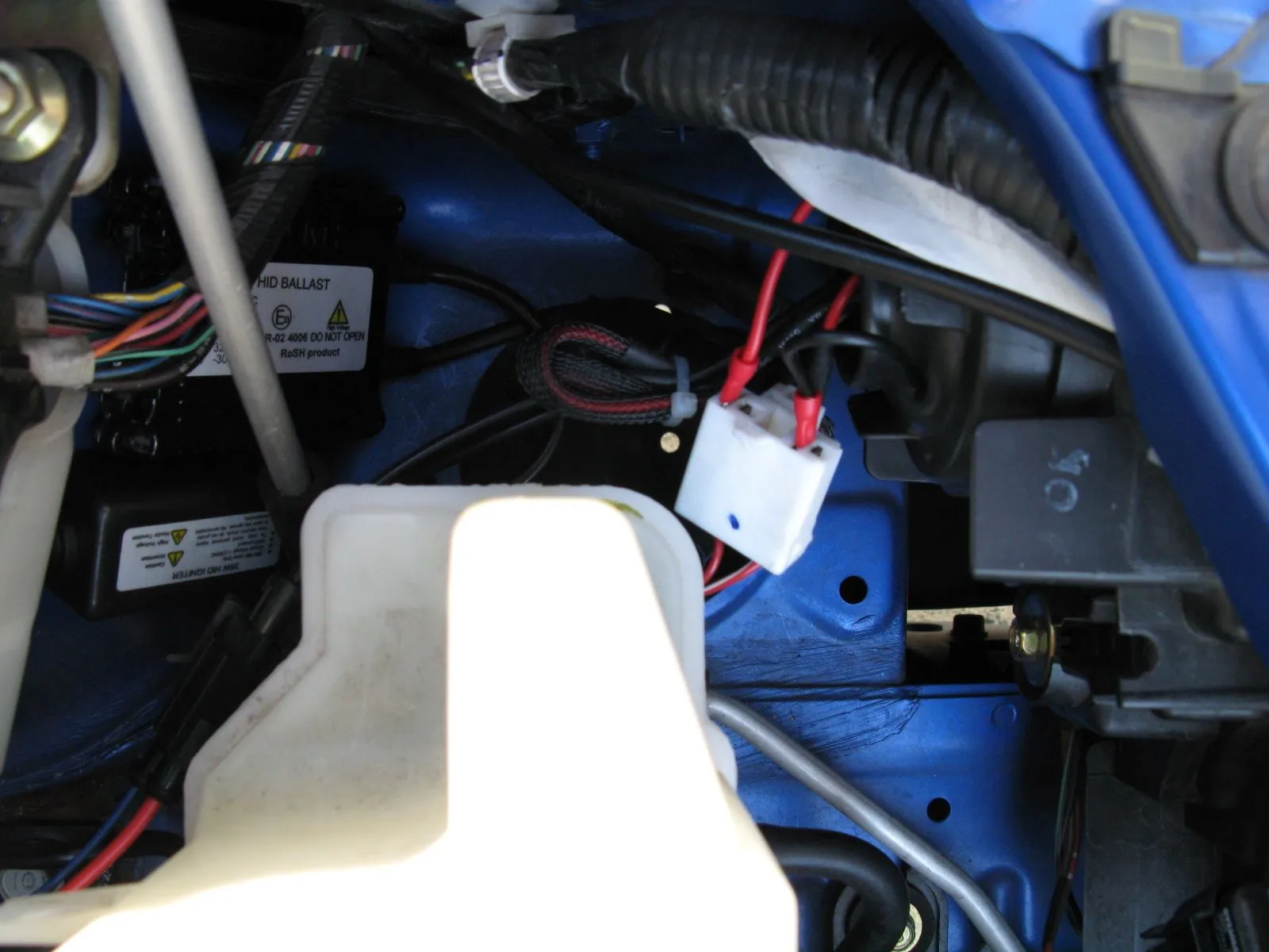

OK I just plug in the wire as the same direction as the driver side and it worked. Now, I wonder do you just leave the connector for the power outside just like that? I'm just worried that if it rains really hard it might create a short, or am I worried too much?
btw, the light is awesome lol.

maxchoa, i've had hid's in both cars with the connectors out and exposed like that and no worries.
Shoot, even the stock headlight plug isn't sealed, so i woulnd't worry about it

On exposed connectors...
I think what you did, maxchao, is awesome. Though personally I've been running exposed, but it does bother me at times, and I will probably end up fixing it like you did, just because I feel I should.
Pro5x2 my HIDS don't have a such defined patern when I light em up against a wall. Did you ajust the alignment?
yeah I also thought of covering the connection but then again, even on the stock setup, they hang out without any protection so..
