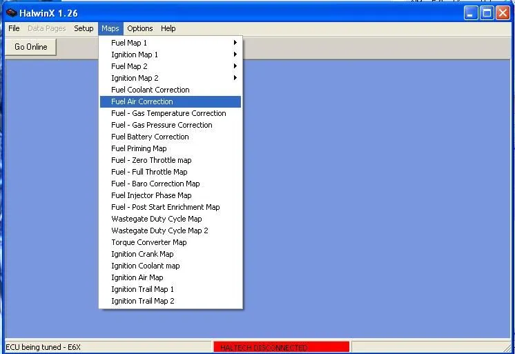

you need to go into the map marked "fuel air correction" with HalwinX and adjust the value for the temperatures your car is in. it is likely dumping too much or not enough fuel.

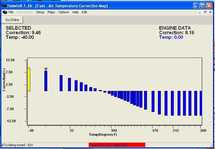

what do you mean you have "moved it all around". you cannot simply tell the haltech you are in cold weather. the haltech reads that the air temp is X degrees and is going to make adjustments to the overall map based the value put into it for X degree. adjusting the main fuel map is also a very bad idea, all you need to do is lower the value in the Fuel Air Correction grid.
i've attached images to this post to help illustrate what i mean. the second picture is your Fuel Air Temp Correction screen. see the values along the bottom? Those are the temperatures stated in degrees. The vertical axis (up and down) represent the amount of correction the Haltech is being told to add. The gray arrow atop the green bar is where the car is currently at temp wise, so you would need to select that bar and decrease it.
ultimately, if you don't have a wideband or don't really know what you are doing, its probably best to have a shop tune this. not calling your competency into question, but tuning is not something that one can "just do" with a few simple clicks.
