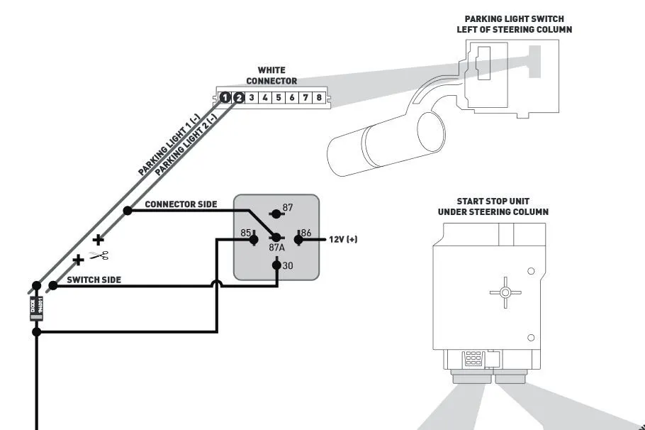

I'm installing a remote start/alarm on my 2017 CX-9 and having an issue with the parking light signal.
The paperwork I have lists it as pins 1&2 on the connector at the light switch and colors blue/black. When I get to this point, I don't find those color wires and the wires in pins 1&2 have a constant 12V that does not change when the parking lights are turned on/off.
If anyone has access to an actual Mazda wiring diagram or manual and could provide some support it would be greatly appreciated.
