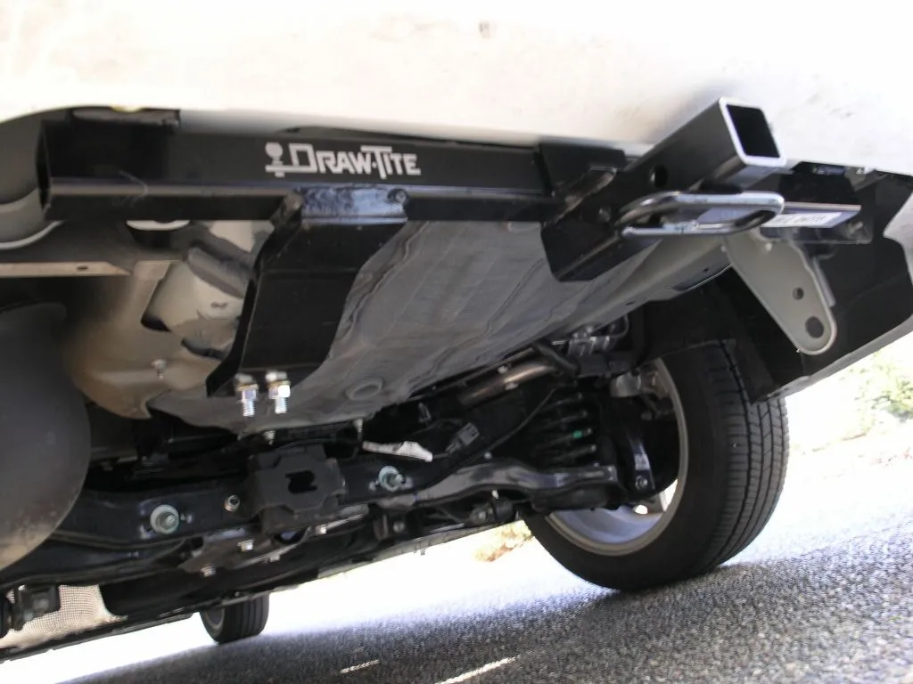

I put the Draw-Tite hitch on my Mazda 5 (see picture) to use with a Yakima bike rack. The hitch is from e-trailer:
http://www.etrailer.com/pc-H~24773.htm?vehicleid=20097474
It's the 1.25" receiver size. The hardest part of installing it was enlarging the holes in the frame to one-half inch with a drill. Make sure to get a very good drill bit for steel. Then it just bolts on once you get the bolts in the holes. E-trailer provides a tool to "fish" the bolts into the holes. The other bolt is a U-bolt that goes through the tow hook. See the instructions on the page in the link.

wow, the video was very helpful! Is it really hard to enlarge the holes in the frame? and will the warranty be voided if I drill on the frame?

NOPE ... we do it at the dealer all the time. Its only say an eighth of an inch larger anyways...drill on and paint the new exposed metal edges.

Not hard to drill at all - just slightly enlarging holes that already are there. Wear safety glasses if you DIY. Don't use a drill bit with a raised tip and edges (which may be fine for wood) - it gave me a bear of a time. Use a regular looking drill bit of the right size. I just bought a Yakima DoubleDown 4 hitch mount as well.

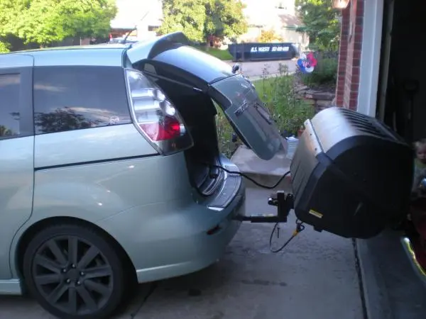

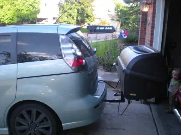

I've installed several of these from etrailer. Piece of cake. The 5 looks easier than any I've done. I just don't need it... yet.
There is an area to run wiring from up behind the passenger side tail light assembly.

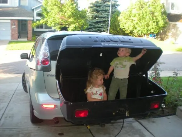

wow! you installed that big cargo carrier in a 1/4 hitch? how is it holding up?
I've been considering buying one of those but I'm concerned about putting it on a 1/4 receiver as its gonna swing like crazy from side to side. It also looks like you need to evenly distribute the weight in the carrier otherwise it's gonna twist the living hell out of that frail receiver. But what do I know! I don't own one! :)
