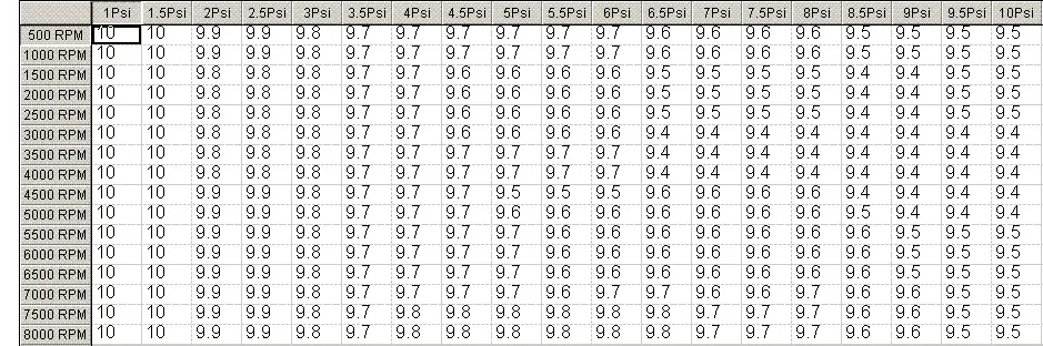

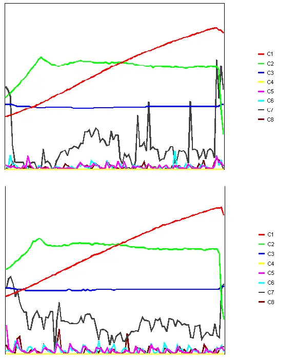

The wide band was delivered today and I spent some time attempting to tune the SS AFC. Here are the charts of before and after and the map which I modified. (red=rpm green=boost gray=AFR) (does anyone know how to get better charts from the SSAFC software? Displaying numbers somewhere in the graph would be helpful)
Any tips would be greatly appreciated! Can the AFC be tuned better to have a smooth AFR chart or are they all wavy like mine?

cool, well the afrs are set on the graph at a very small scale so they look like they are bouncing around but really if you just increased the scale it would look flat.. but you don't want that because you want to be able to fine tune it.. and no you can't really get it much flatter, as long as it is generally stable you'll get small adjustments in afr like +/- .5 or something like that with a good tune, and there will always be random dips and spikes and stuff like that
and as far as different charts, other than being able to see the values or what they are in the tables/legend thing on the sides (like I assume you noticed the afr levels and cell value and boost numbers on the side of the graph (it's not shown in the pic but you should see it pretty easily when you'll looking at them on the computer)
