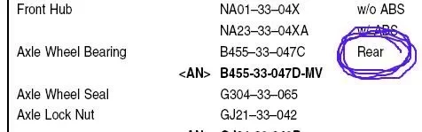

interesting. last time I replaced a hub, it looked like the bearings rode on the inside of the hub, with just the metal seal and outsides of the races holding them in, hence why repacking them is not a long term fix, since you cannot get the bearing seal from mazda. At least, thats what the guy at mazda motorsports who has been helping us in getting the parts to build our specmiata said...
I'll be sure to have my pops ask about that part#...
tho a quick google of that part# shows several online stores showing that part# as the whole hub, including lug studs... not just the bearing.
You have a 99 model right?
http://www.mazdamotorsports.com/pdfs/fmp/fmp_mx5_99.pdf
SEARCH -
B455-33-047C
This is a STOCK part.
I royally pawned myself on that one..haha.
I swore it said front.
*scurries away*
